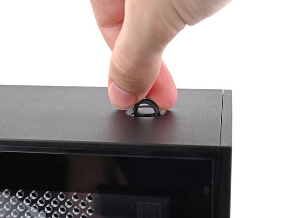

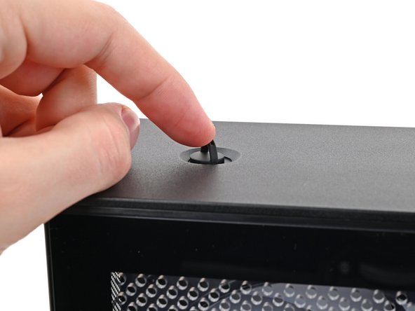

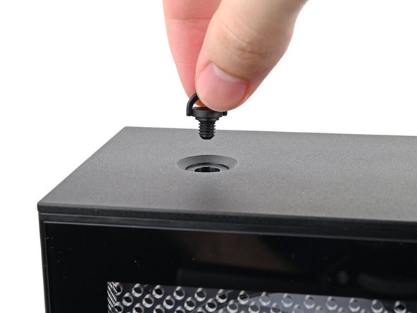

  1. Use your finger to lift up the two D-rings on the Top Panel screws. Use your finger to lift up the two D-rings on the Top Panel screws. Use your finger to lift up the two D-rings on the Top Panel screws.

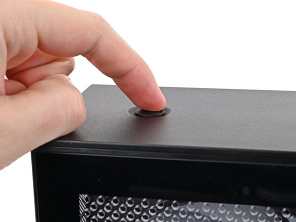

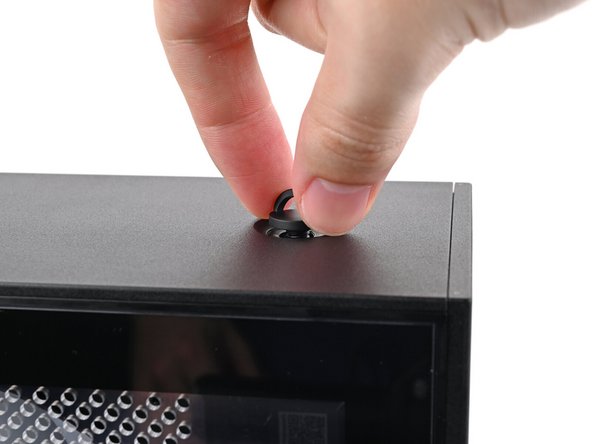

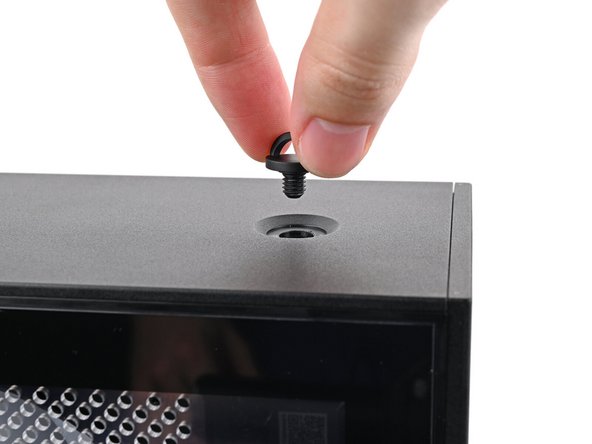

  2. Use your fingers to twist the screw counter-clockwise and loosen it. Remove the Top Panel screw. Remove the Top Panel screw.
    • Remove the Top Panel screw.

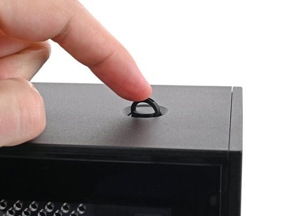

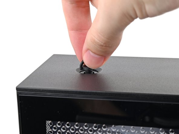

  3. Repeat the same procedure for the other Top Panel screw. Repeat the same procedure for the other Top Panel screw. Repeat the same procedure for the other Top Panel screw.

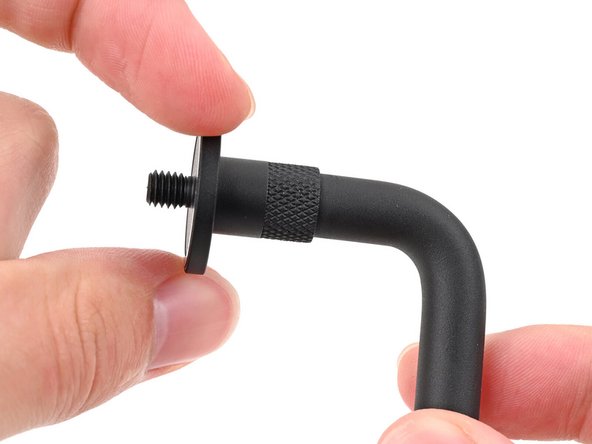

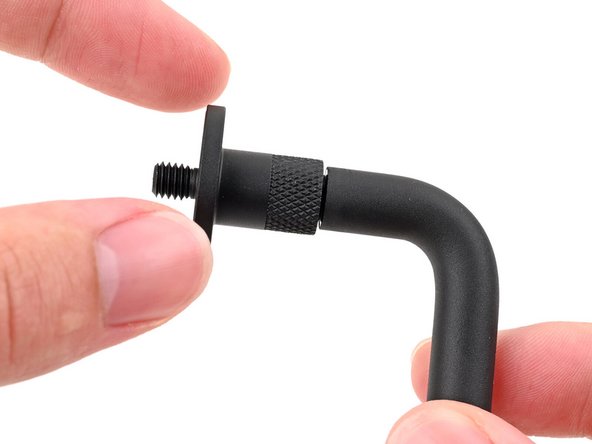

  4. Rotate the screw threads on both sides counterclockwise to ensure they're as high up as they go. Otherwise, they might not install correctly. Rotate the screw threads on both sides counterclockwise to ensure they're as high up as they go. Otherwise, they might not install correctly.
    • Rotate the screw threads on both sides counterclockwise to ensure they're as high up as they go. Otherwise, they might not install correctly.

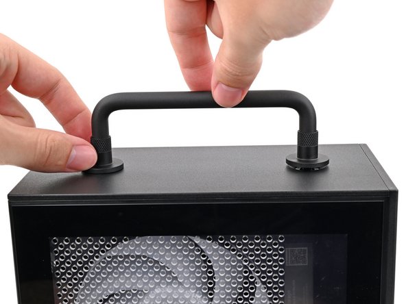

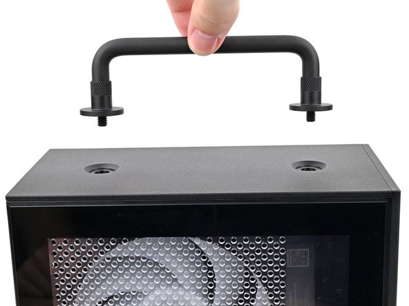

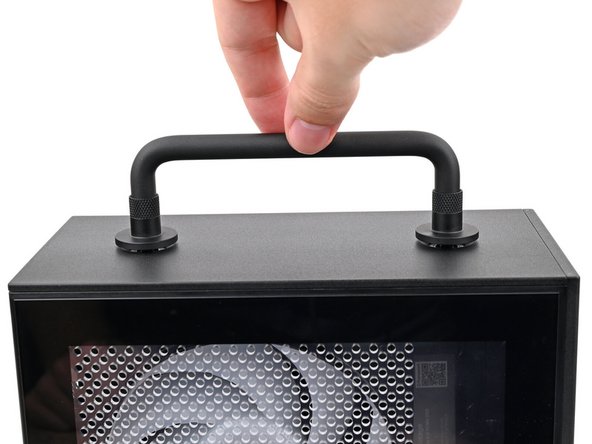

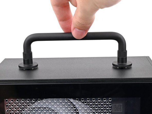

  5. Place the Handle over the Top Panel screw holes. Place the Handle over the Top Panel screw holes.

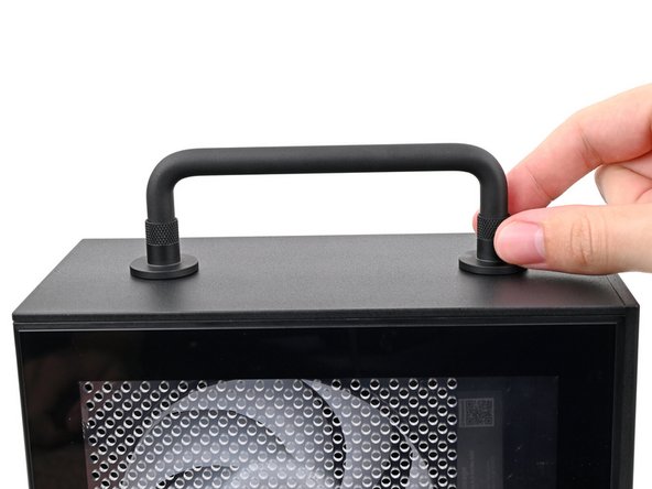

  6. While holding the Handle in place, twist the screw threads on both sides clockwise until they're snug on the Top Panel. While holding the Handle in place, twist the screw threads on both sides clockwise until they're snug on the Top Panel.
