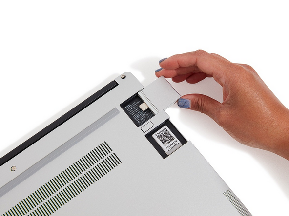

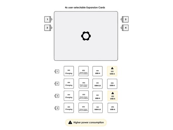

  9. Insert the Expansion Cards of your choice. With keyboard face up, this configuration supports USB 4 and DP 2.0 UHBR20 on the upper left and right slots. The lower left slot supports USB 3.2 and DP 1.4 HBR3; lower right supports DP 2.0 UHBR10. All ports can be used for charging via USB. A diagram of Expansion Card compatibility can be found here. Note that USB-A Expansion Cards when placed in the back two slots will result in higher power consumption. Check the KB article for more detail on this.
    • Insert the Expansion Cards of your choice. With keyboard face up, this configuration supports USB 4 and DP 2.0 UHBR20 on the upper left and right slots. The lower left slot supports USB 3.2 and DP 1.4 HBR3; lower right supports DP 2.0 UHBR10.
    • All ports can be used for charging via USB. A diagram of Expansion Card compatibility can be found here.
    • Note that USB-A Expansion Cards when placed in the back two slots will result in higher power consumption. Check the KB article for more detail on this.
    • The text, logo, and QR code on the Expansion Card must be facing down (facing the laptop). Slide the Expansion card into the bay. Using two or more fingers push the card until into the bay until it clicks.
    • You will have to use a slight amount of force to ensure proper installation of the Expansion Cards.

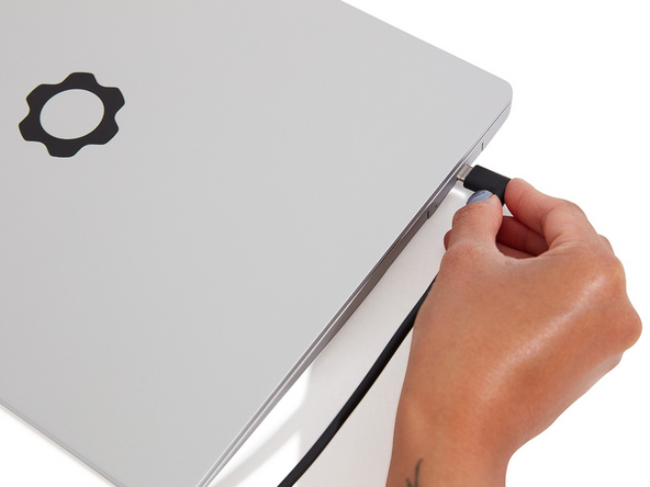

    • Plug your power cable into the USB-C Expansion Card.

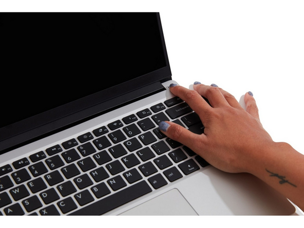

    • Open the lid on your Framework Laptop and press the power button.
    • Note that your first boot will take a while before the logo comes up on screen as the system does memory training. The more memory you've installed, the longer this could take (on the order of a minute or two with 64GB!)
