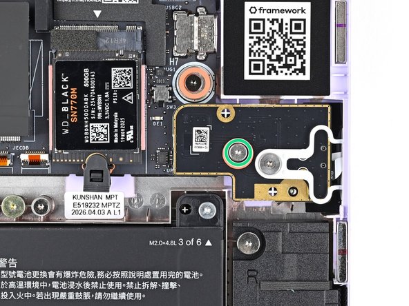

  7. Use your Framework Screwdriver to loosen the captive T5 Torx screw securing the Fingerprint Reader.
    • Use your Framework Screwdriver to loosen the captive T5 Torx screw securing the Fingerprint Reader.

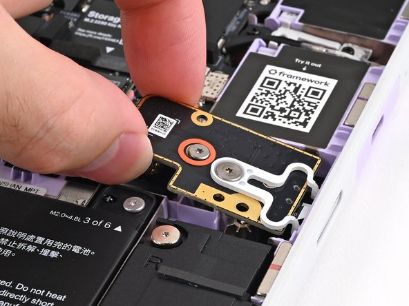

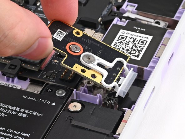

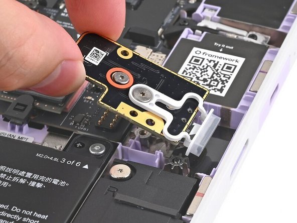

  8. Use your fingers to lift and remove the Fingerprint Reader. Use your fingers to lift and remove the Fingerprint Reader. Use your fingers to lift and remove the Fingerprint Reader.
    • Use your fingers to lift and remove the Fingerprint Reader.

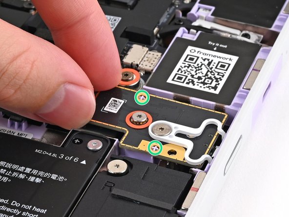

  10. Use your fingers to lay the Fingerprint Reader in place. Use the two plastic pins on the laptop to align the Fingerprint Reader. Use the two plastic pins on the laptop to align the Fingerprint Reader.
    • Use your fingers to lay the Fingerprint Reader in place.
    • Use the two plastic pins on the laptop to align the Fingerprint Reader.
  11. Use your Framework Screwdriver to tighten the captive T5 Torx screw to secure the Fingerprint Reader.
    • Use your Framework Screwdriver to tighten the captive T5 Torx screw to secure the Fingerprint Reader.
    • Tighten the screw until it's snug. Don't over-tighten it, or you may strip the screw.
