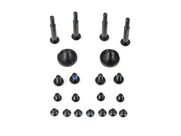

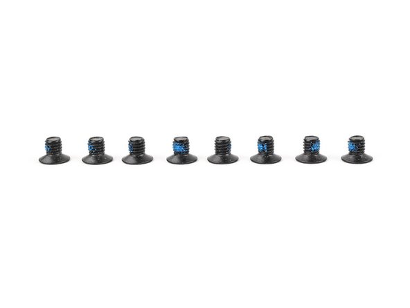

  1. The Fastener Kit contains the following: Four screws labeled "6.0 mm fastener with a 7.3 mm diameter 2.3 mm thick"
    • The Fastener Kit contains the following:
    • Four screws labeled "6.0 mm fastener with a 7.3 mm diameter 2.3 mm thick"

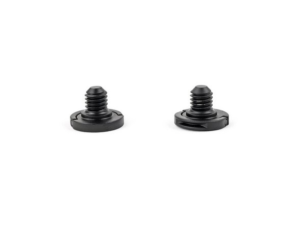

    • Two large screws labeled "M6 ring screws"
    • Four screws labeled "4.0 mm fastener with a 5.5 mm diameter 2.0 mm thick"
    • Eight screws labeled "4.0 mm fastener with a 5.5 mm diameter 0.9 mm thick"
    • Four long screws labeled "26.5 mm fastener with a 7.0 mm diameter 2.0 mm thick"

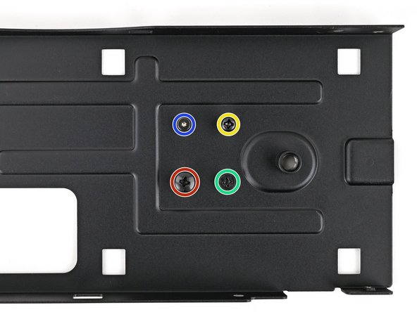

    • Your Framework Desktop comes with a spare screw of each size attached to the bottom of the top plate. You can use the Fastener Kit to replenish any screws you used there.
    • Not included in the Fastener Kit is a silver 4.5 mm‑long T5 Torx screw that secures the SSD covers, I/O shield, and USB‑C brackets.

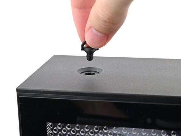

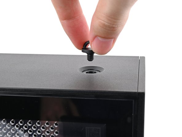

  2. The two screws labeled "M6 ring screws" secure the Top Panel. The two screws labeled "M6 ring screws" secure the Top Panel. The two screws labeled "M6 ring screws" secure the Top Panel.
    • The two screws labeled "M6 ring screws" secure the Top Panel.

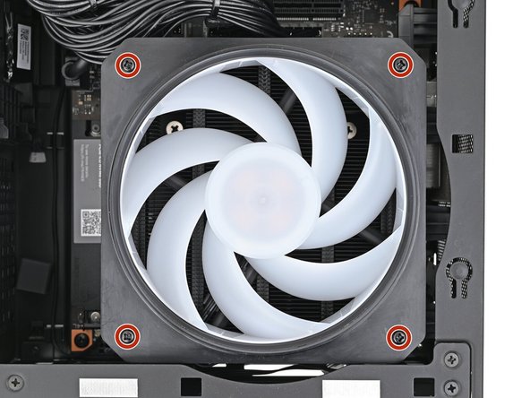

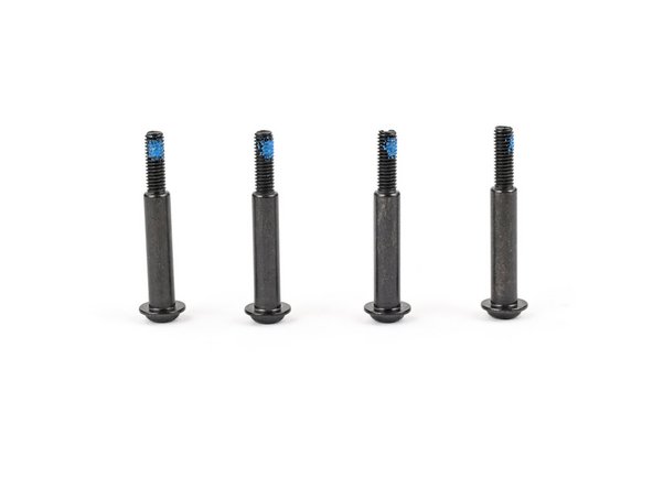

  3. The long screws labeled "26.5 mm fastener with a 7.0 mm diameter 2.0 mm thick" secure the Fan. The long screws labeled "26.5 mm fastener with a 7.0 mm diameter 2.0 mm thick" secure the Fan.
    • The long screws labeled "26.5 mm fastener with a 7.0 mm diameter 2.0 mm thick" secure the Fan.

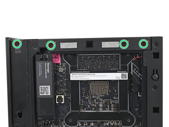

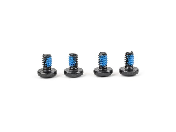

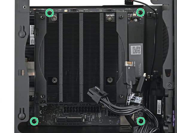

  4. The screws labeled "6.0 mm fastener with a 7.3 mm diameter 2.3 mm thick" secure the Mainboard. The screws labeled "6.0 mm fastener with a 7.3 mm diameter 2.3 mm thick" secure the Mainboard.
    • The screws labeled "6.0 mm fastener with a 7.3 mm diameter 2.3 mm thick" secure the Mainboard.

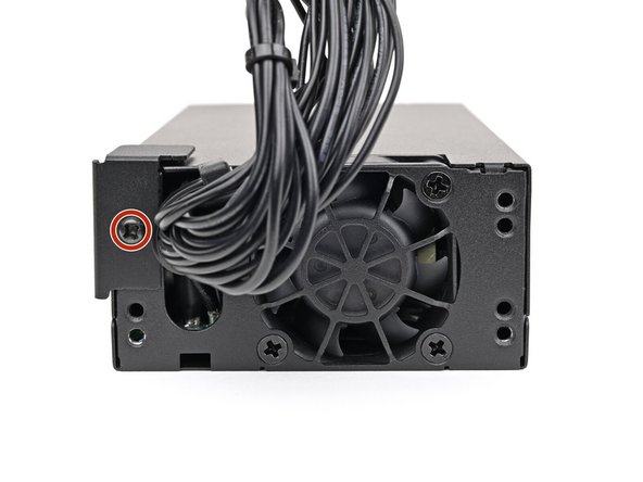

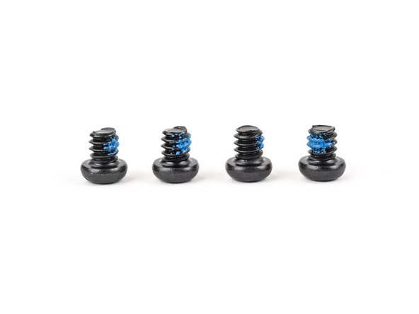

  5. The screws labeled "4.0 mm fastener with a 5.5 mm diameter 2.0 mm thick" secure the power supply. The screws labeled "4.0 mm fastener with a 5.5 mm diameter 2.0 mm thick" secure the power supply.
    • The screws labeled "4.0 mm fastener with a 5.5 mm diameter 2.0 mm thick" secure the power supply.

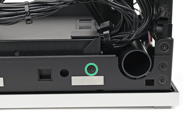

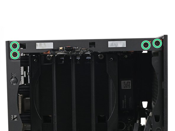

  6. The screws labeled "4.0 mm fastener with a 5.5 mm diameter 0.9 mm thick" secure the top plate. The screws labeled "4.0 mm fastener with a 5.5 mm diameter 0.9 mm thick" secure the top plate. The screws labeled "4.0 mm fastener with a 5.5 mm diameter 0.9 mm thick" secure the top plate.
    • The screws labeled "4.0 mm fastener with a 5.5 mm diameter 0.9 mm thick" secure the top plate.

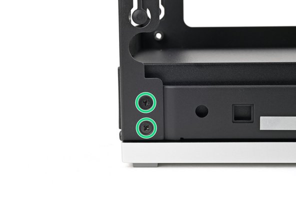

  7. The screws labeled "4.0 mm fastener with a 5.5 mm diameter 0.9 mm thick" secure the rear plate. The screws labeled "4.0 mm fastener with a 5.5 mm diameter 0.9 mm thick" secure the rear plate. The screws labeled "4.0 mm fastener with a 5.5 mm diameter 0.9 mm thick" secure the rear plate.
    • The screws labeled "4.0 mm fastener with a 5.5 mm diameter 0.9 mm thick" secure the rear plate.

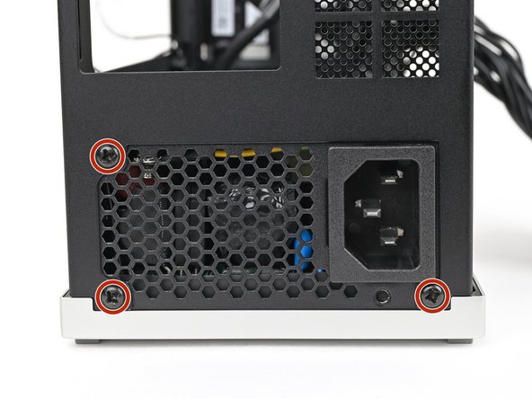

  8. The screws labeled "4.0 mm fastener with a 5.5 mm diameter 0.9 mm thick" secure the side of the power supply. The screws labeled "4.0 mm fastener with a 5.5 mm diameter 0.9 mm thick" secure the side of the power supply.
    • The screws labeled "4.0 mm fastener with a 5.5 mm diameter 0.9 mm thick" secure the side of the power supply.
