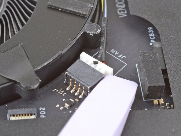

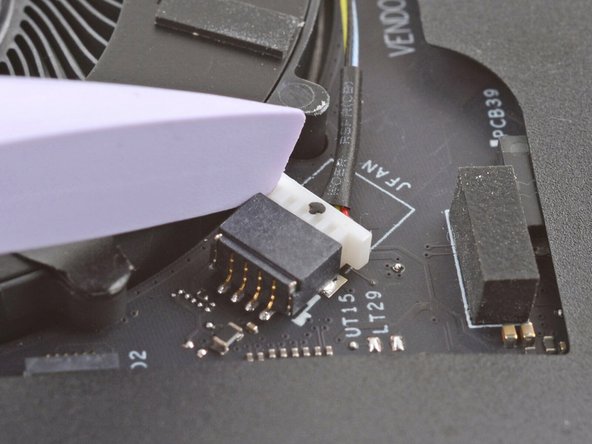

  7. Use the flat end of your Framework Screwdriver to gently push on one of the fan connector's protruding edges, then the other, to loosen the connector out of its socket. Use the flat end of your Framework Screwdriver to gently push on one of the fan connector's protruding edges, then the other, to loosen the connector out of its socket. Use the flat end of your Framework Screwdriver to gently push on one of the fan connector's protruding edges, then the other, to loosen the connector out of its socket.
    • Use the flat end of your Framework Screwdriver to gently push on one of the fan connector's protruding edges, then the other, to loosen the connector out of its socket.

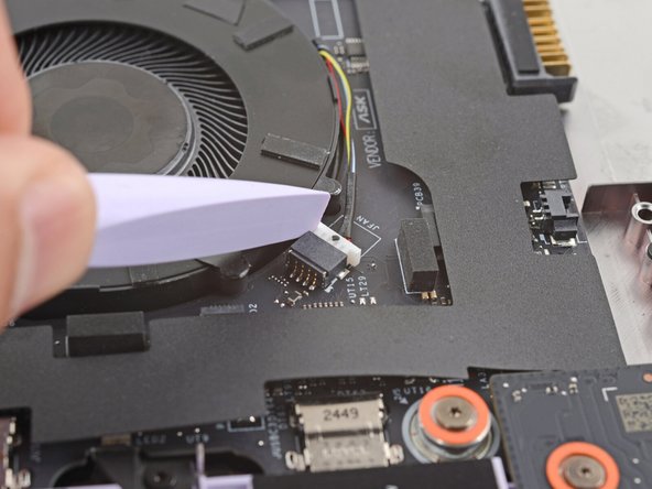

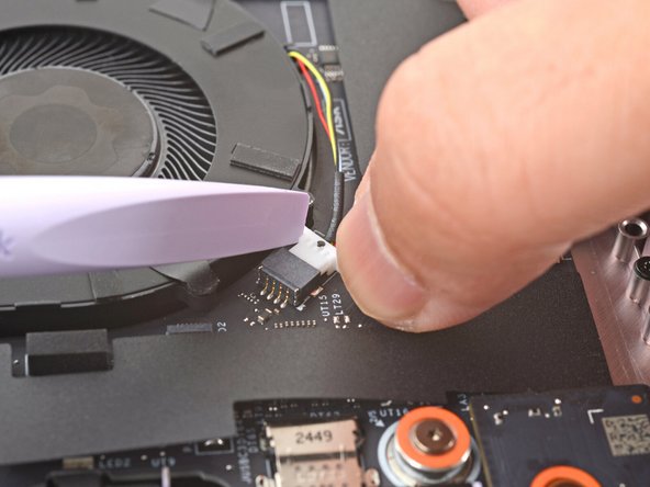

  8. Use your fingers and your Framework Screwdriver to slide the fan connector out of its socket. Use your fingers and your Framework Screwdriver to slide the fan connector out of its socket.
    • Use your fingers and your Framework Screwdriver to slide the fan connector out of its socket.

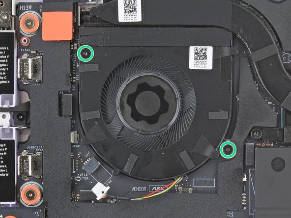

  9. Use your Framework Screwdriver to loosen the two captive T5 Torx screws securing the fan.
    • Use your Framework Screwdriver to loosen the two captive T5 Torx screws securing the fan.

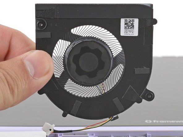

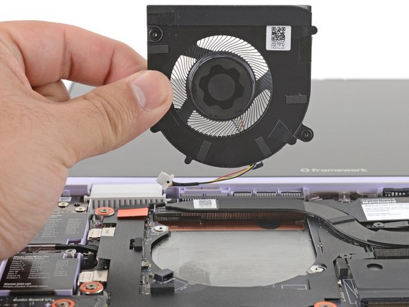

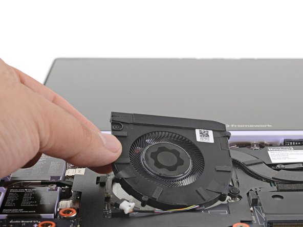

  10. Lift and remove the fan. Lift and remove the fan.
    • Lift and remove the fan.

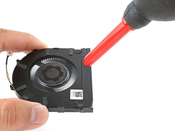

  11. If your fan's dirty, this is a great opportunity to clean it! A clean fan will help your laptop stay cooler. Use a soft bristled brush or a clean toothbrush to gently scrub the fan blades and exhaust fins.
    • If your fan's dirty, this is a great opportunity to clean it! A clean fan will help your laptop stay cooler.
    • Use a soft bristled brush or a clean toothbrush to gently scrub the fan blades and exhaust fins.
    • Use a dust blower to blow away the dust from the fan.

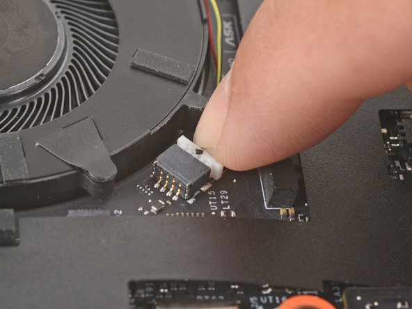

  15. Use your fingers to gently push the fan connector back into its socket. Don't push too hard, or you may break the socket. If you're having trouble, wiggle the connector slightly to help it slide into the socket.
    • Use your fingers to gently push the fan connector back into its socket.
    • Don't push too hard, or you may break the socket. If you're having trouble, wiggle the connector slightly to help it slide into the socket.
