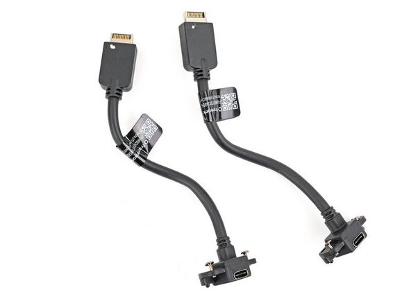

Follow this guide to remove and replace the Expansion Card cables in your Framework Desktop.
These cables connect the two Expansion Card slots at the front of the Desktop to the Mainboard.

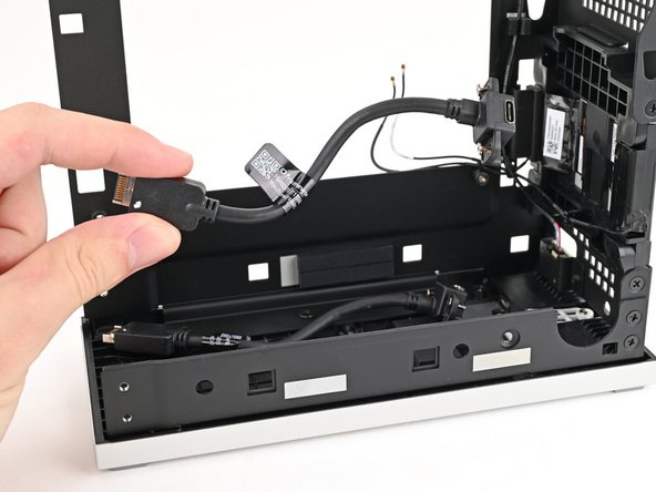

  13. Lift the fan out of the chassis, making sure the cables thread through the side of the heatsink. Lift the fan out of the chassis, making sure the cables thread through the side of the heatsink. Lift the fan out of the chassis, making sure the cables thread through the side of the heatsink.
    • Lift the fan out of the chassis, making sure the cables thread through the side of the heatsink.
  14. Pull the top Expansion Card connector straight out of its socket in the Mainboard to disconnect it. Pull the top Expansion Card connector straight out of its socket in the Mainboard to disconnect it.
    • Pull the top Expansion Card connector straight out of its socket in the Mainboard to disconnect it.

  17. Pull the bottom Expansion Card connector straight out of its socket in the Mainboard to disconnect it. Pull the bottom Expansion Card connector straight out of its socket in the Mainboard to disconnect it.
    • Pull the bottom Expansion Card connector straight out of its socket in the Mainboard to disconnect it.

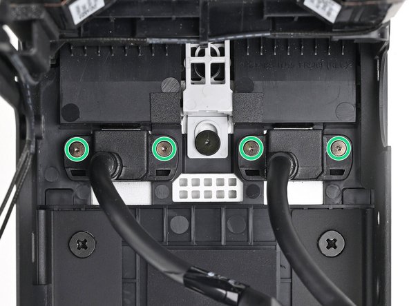

  36. Use your Framework Desktop Screwdriver to loosen the four captive T5 Torx screws securing the two Expansion Card cables. Use your Framework Desktop Screwdriver to loosen the four captive T5 Torx screws securing the two Expansion Card cables.
    • Use your Framework Desktop Screwdriver to loosen the four captive T5 Torx screws securing the two Expansion Card cables.

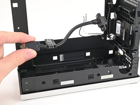

  37. Lift the Expansion Card cables out of the Desktop and remove them. Lift the Expansion Card cables out of the Desktop and remove them.
    • Lift the Expansion Card cables out of the Desktop and remove them.

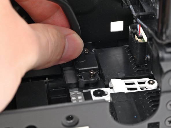

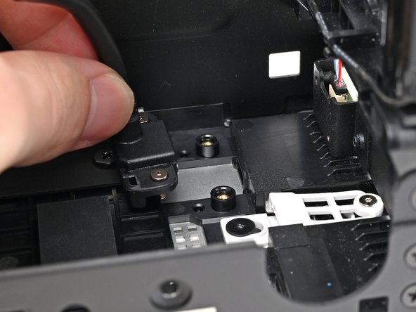

  39. Insert the the Expansion Card cable into its slot and align it over its two screw pegs. Repeat for the other Expansion Card cable.
    • Insert the the Expansion Card cable into its slot and align it over its two screw pegs.

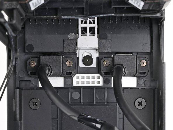

  40. Use your Framework Desktop Screwdriver to install the four captive T5 Torx screws securing the two Expansion Card cables. Use your Framework Desktop Screwdriver to install the four captive T5 Torx screws securing the two Expansion Card cables.
    • Use your Framework Desktop Screwdriver to install the four captive T5 Torx screws securing the two Expansion Card cables.

    • Slide the cable into its socket on the Mainboard until you feel it click into place.
  62. Slide the top Expansion Card cable into its socket on the Mainboard. Slide the top Expansion Card cable into its socket on the Mainboard.
    • Slide the top Expansion Card cable into its socket on the Mainboard.
