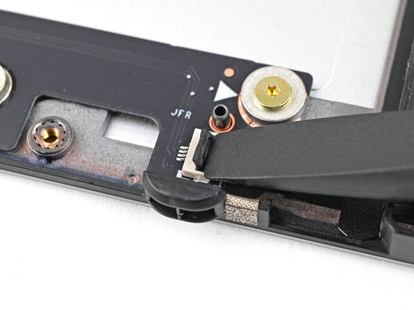

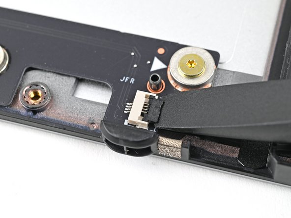

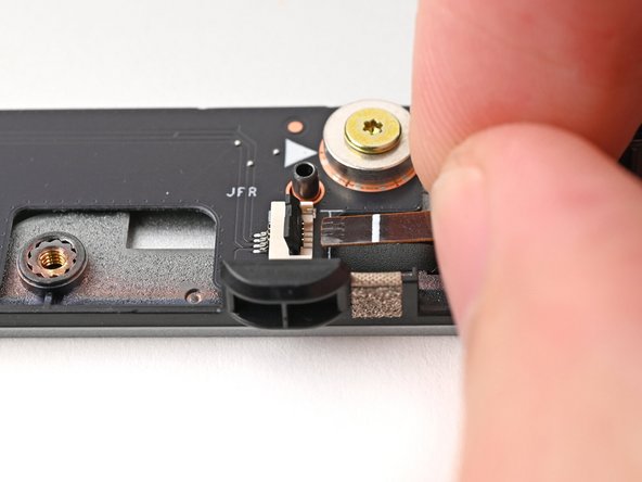

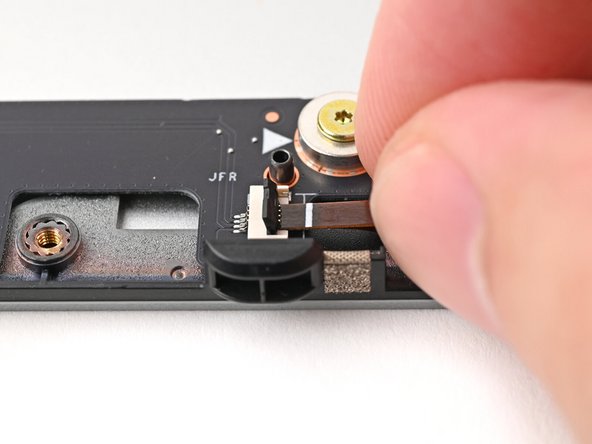

Use the flat end of your Framework Screwdriver, or a clean fingernail, to lift up and release the locking tab on the fan ZIF connectors.

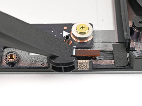

Use your fingers to grip the brown pull tab and slide the fan cable straight out of its socket.

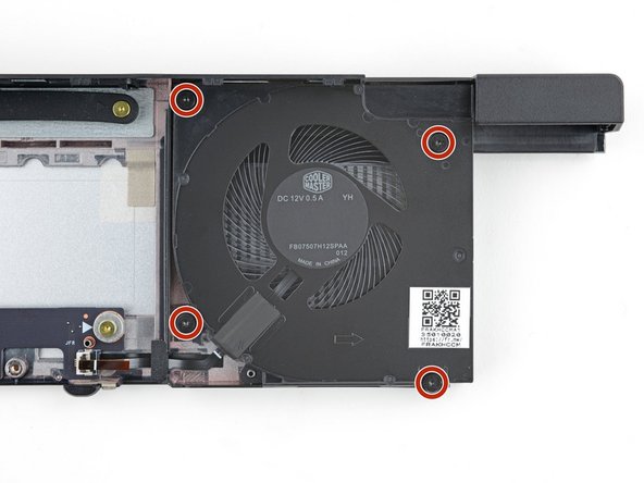

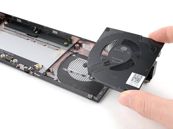

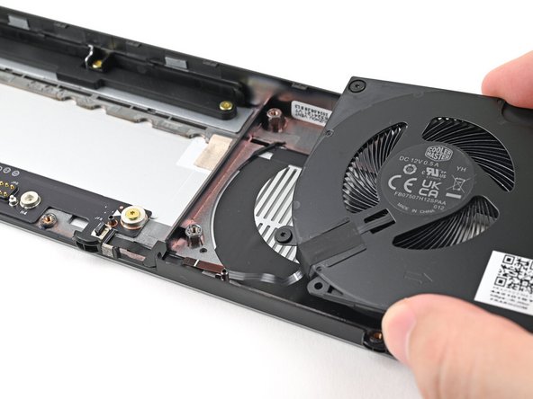

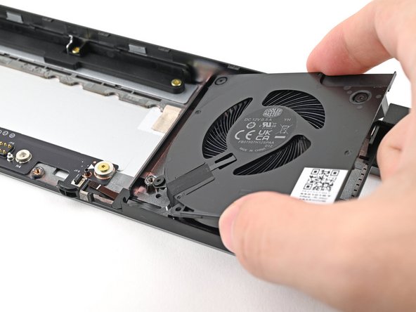

Use your Framework Screwdriver to loosen the four captive Torx T5 screws securing the fan.

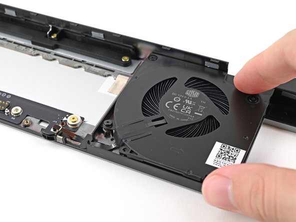

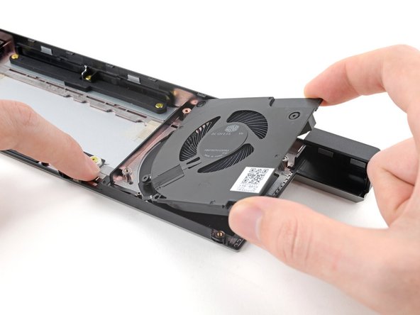

Use one hand to press the fan cable flat to the module.

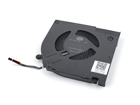

Use your other hand to pull the fan out of its housing, making sure to thread the cable through its slot.
Congratulations on completing disassembly! The remaining steps will show how to reassemble your Framework Laptop.

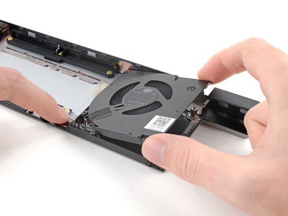

Place the fan onto the Expansion Bay Shell, making sure to thread the cable through its slot.
Use your Framework Screwdriver to tighten the four captive Torx T5 screws securing the fan.

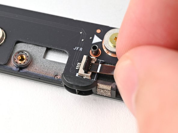

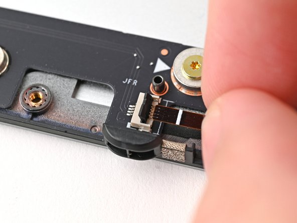

Use your fingers to grip the brown pull tab and slide the fan cable straight into its socket.
Use the flat end of your Framework Screwdriver, or a clean fingernail, to press down the locking tab on the right fan ZIF connector.
