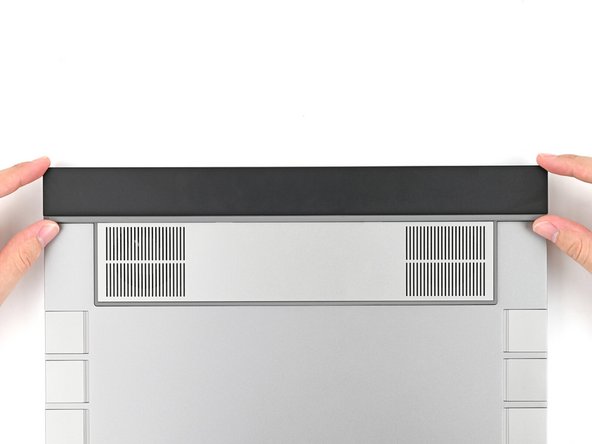

    • Remove the keyboard.
    • Remove the Input Module.

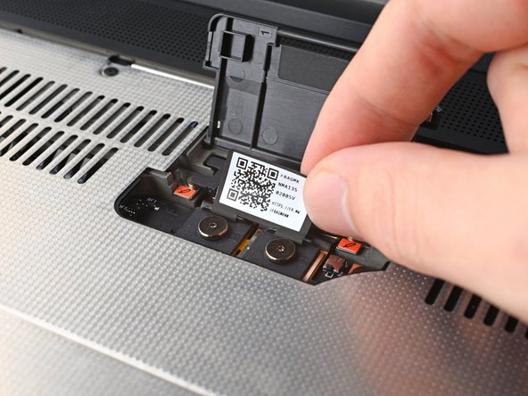

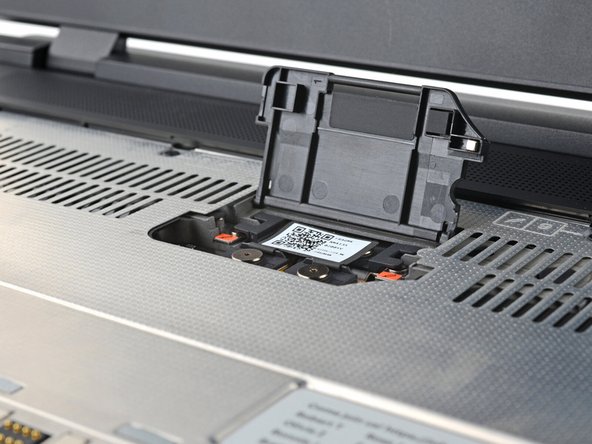

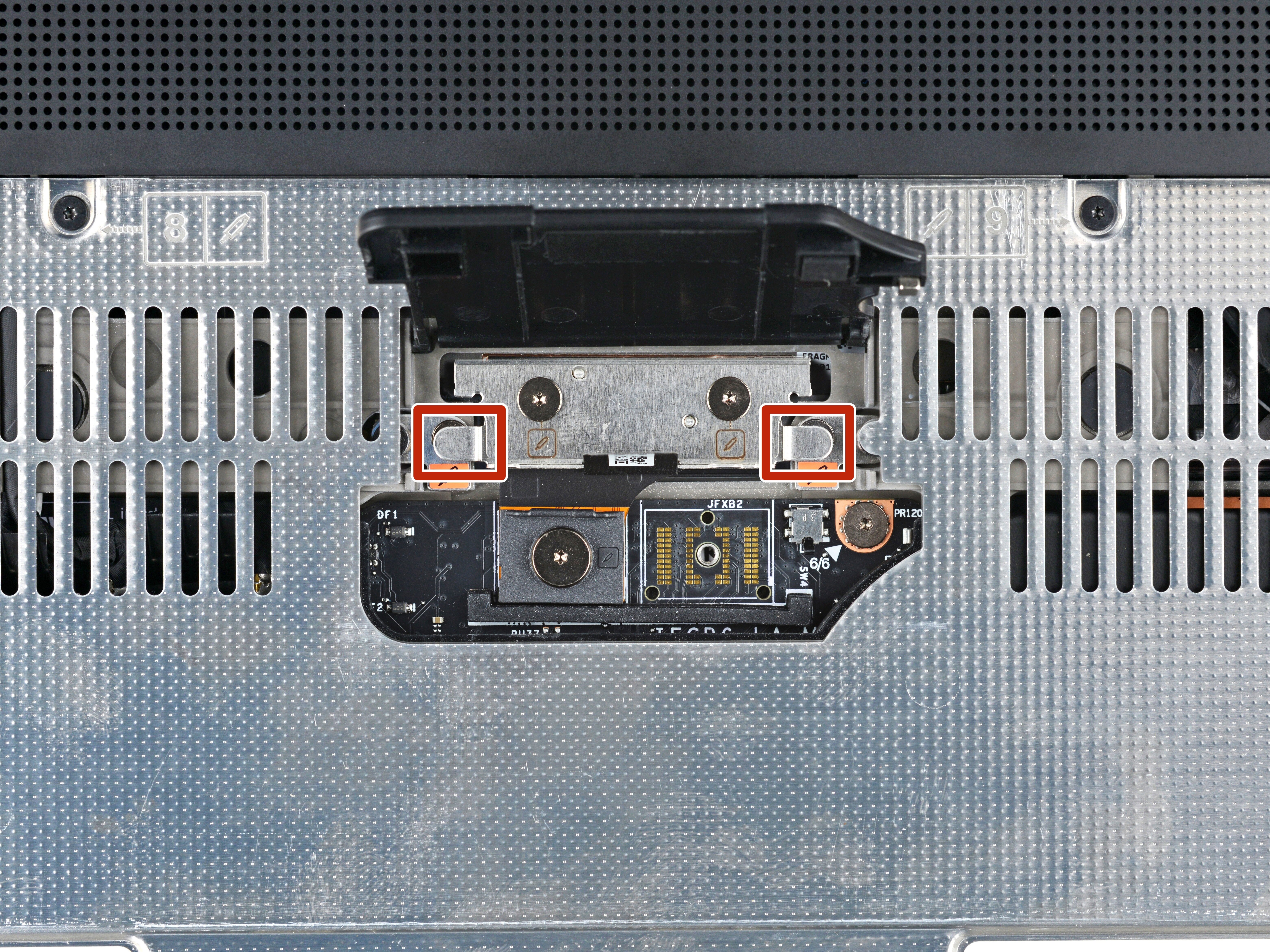

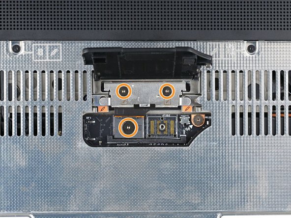

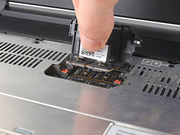

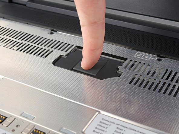

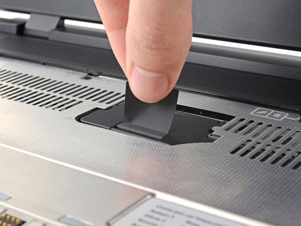

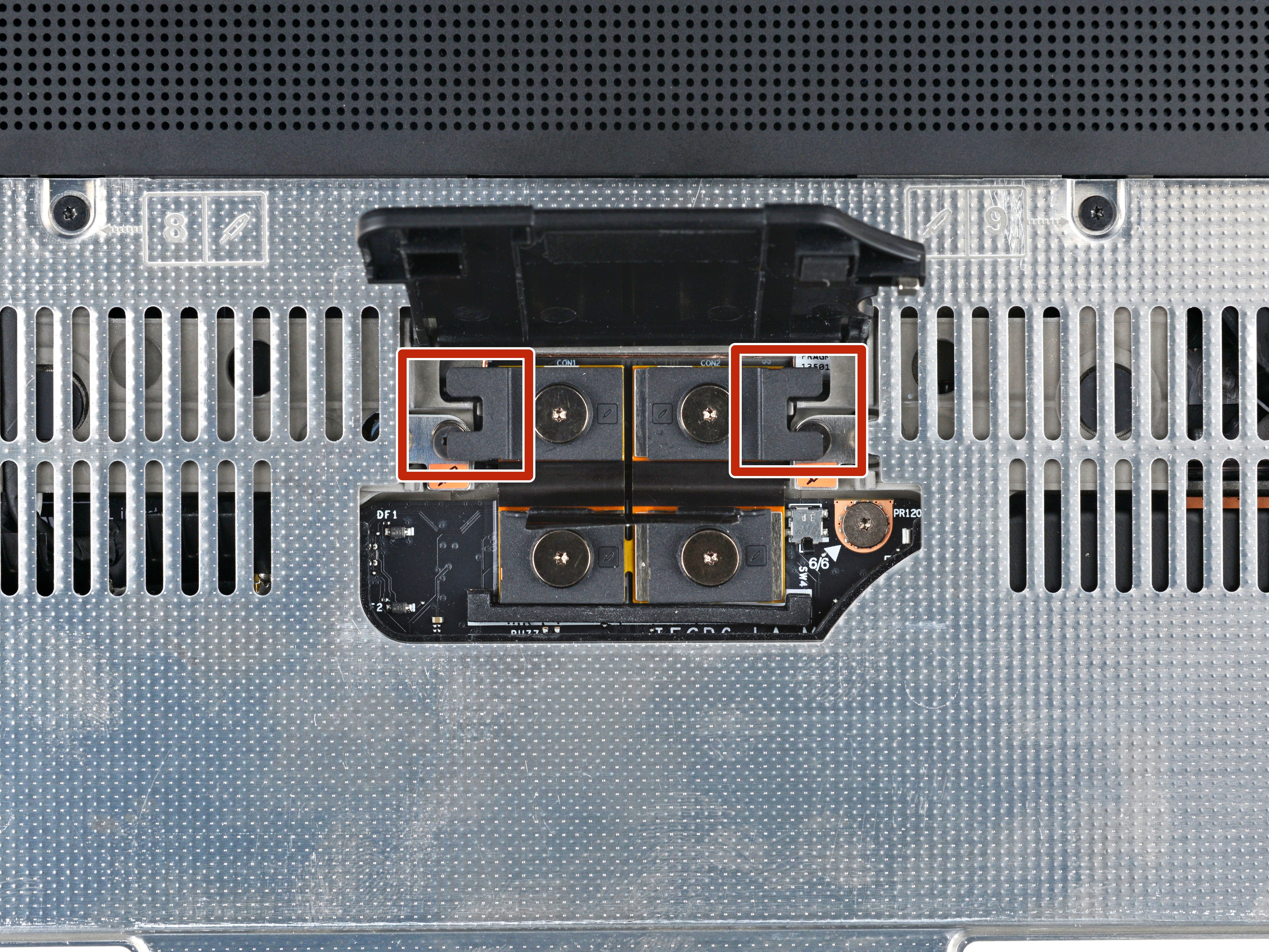

  8. Lift the interposer door by its black pull tab and let it rest upright. Lift the interposer door by its black pull tab and let it rest upright.
    • Lift the interposer door by its black pull tab and let it rest upright.

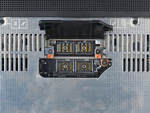

  9. If you have the Graphics Module installed, your interposer will have four screws. If you have the Expansion Bay Shell installed, you'll have three screws instead. If you have the Graphics Module, use your Framework Screwdriver to loosen the four captive T5 Torx screws securing the interposer. If you have the Expansion Bay Shell, use your Framework Screwdriver to loosen the three captive T5 Torx screws securing the interposer.
    • If you have the Graphics Module installed, your interposer will have four screws. If you have the Expansion Bay Shell installed, you'll have three screws instead.
    • If you have the Graphics Module, use your Framework Screwdriver to loosen the four captive T5 Torx screws securing the interposer.
    • If you have the Expansion Bay Shell, use your Framework Screwdriver to loosen the three captive T5 Torx screws securing the interposer.

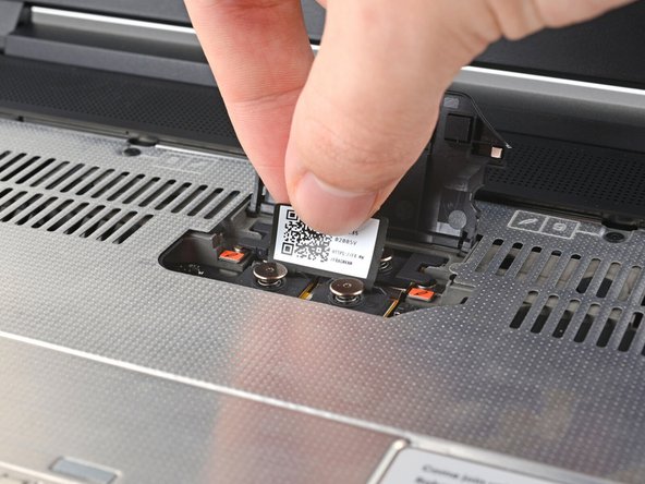

  10. Lift the interposer by its pull tab and remove it. Lift the interposer by its pull tab and remove it.
    • Lift the interposer by its pull tab and remove it.

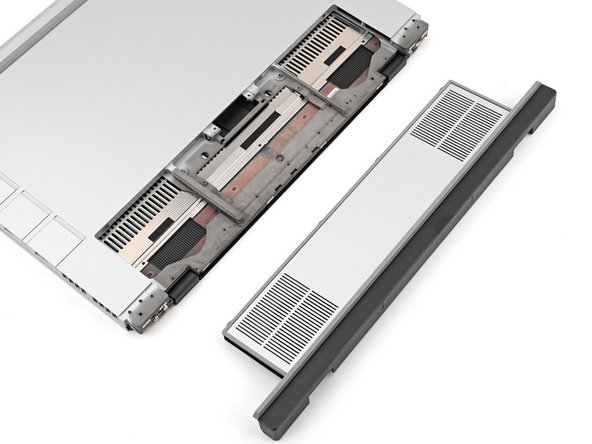

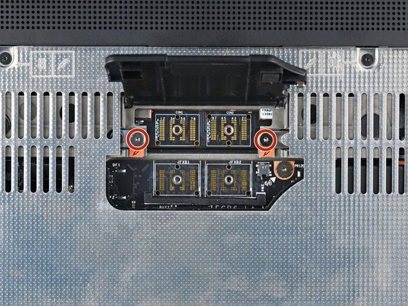

  11. Use your Framework Screwdriver to loosen the two captive T5 Torx screws securing the Expansion Bay Module. Close the interposer door before continuing.
    • Use your Framework Screwdriver to loosen the two captive T5 Torx screws securing the Expansion Bay Module.
    • Close the interposer door before continuing.

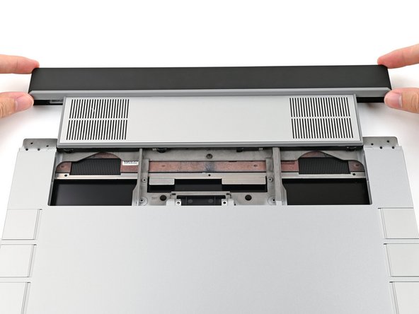

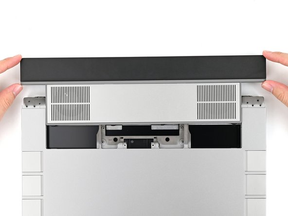

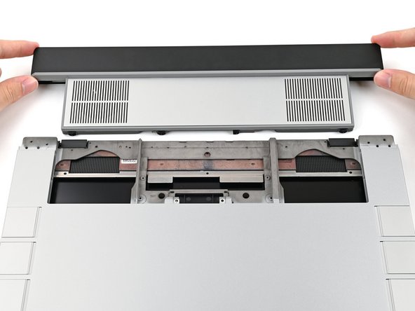

  12. Close your laptop and flip it over. Slide the Expansion Bay Module out of the laptop and remove it. The module should slide out easily. If you feel any resistance, check that the screws holding it in place are fully loosened.
    • Close your laptop and flip it over.
    • Slide the Expansion Bay Module out of the laptop and remove it.
    • The module should slide out easily. If you feel any resistance, check that the screws holding it in place are fully loosened.

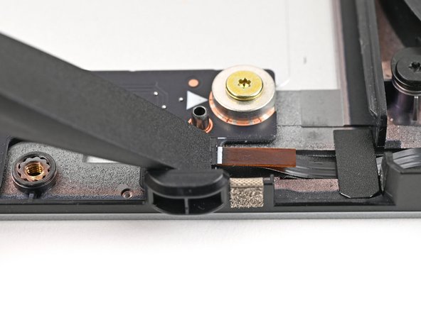

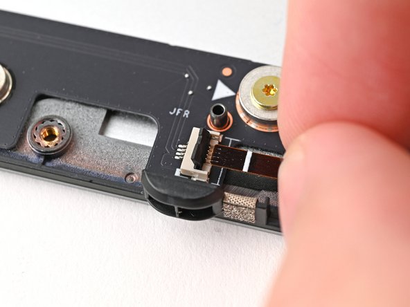

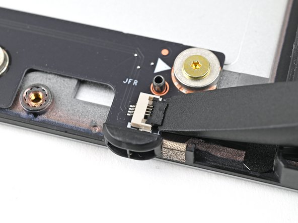

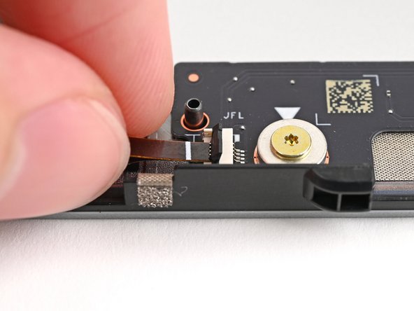

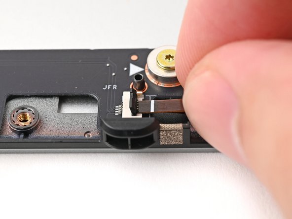

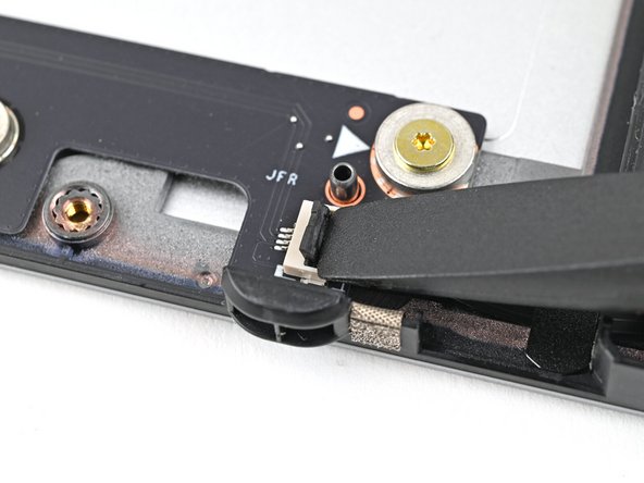

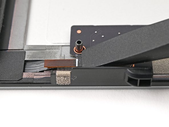

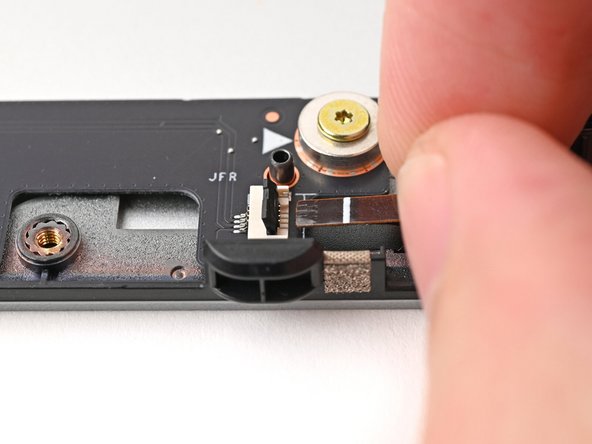

  13. Use the flat end of your Framework Screwdriver, or a clean fingernail, to lift up and release the locking tab on the right fan ZIF connector. Use your fingers to grip the brown pull tab and slide the right fan cable straight out of its socket. Use your fingers to grip the brown pull tab and slide the right fan cable straight out of its socket.
    • Use the flat end of your Framework Screwdriver, or a clean fingernail, to lift up and release the locking tab on the right fan ZIF connector.
    • Use your fingers to grip the brown pull tab and slide the right fan cable straight out of its socket.

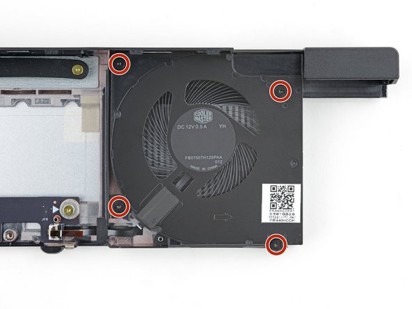

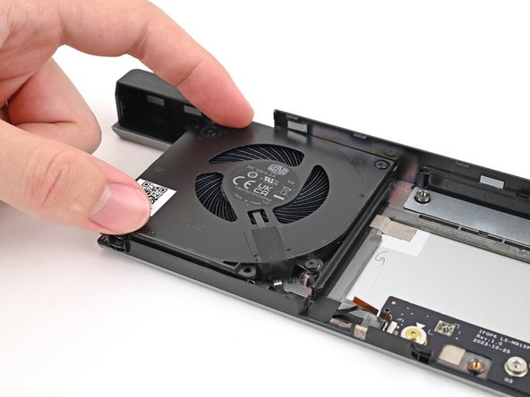

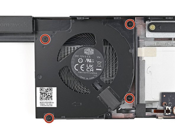

  14. Use your Framework Screwdriver to loosen the four captive Torx T5 screws securing the right fan. Use your Framework Screwdriver to loosen the four captive Torx T5 screws securing the right fan.
    • Use your Framework Screwdriver to loosen the four captive Torx T5 screws securing the right fan.

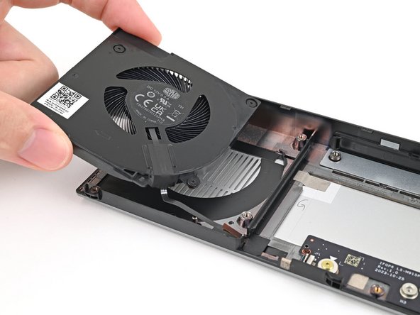

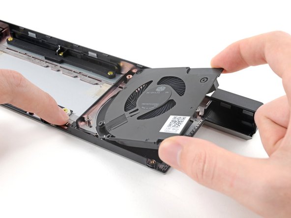

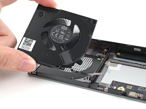

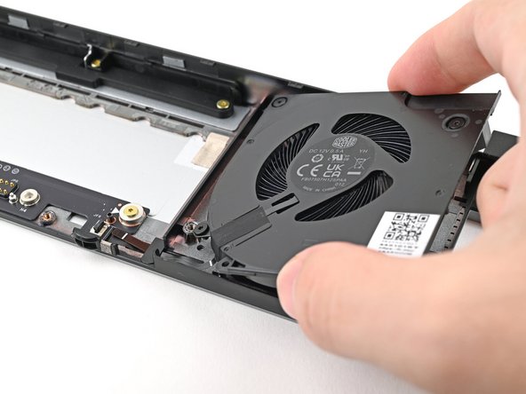

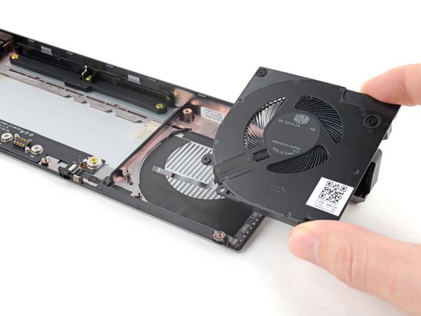

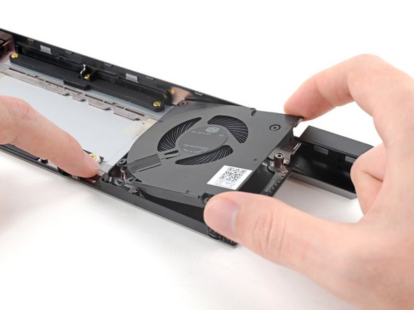

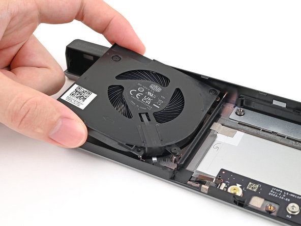

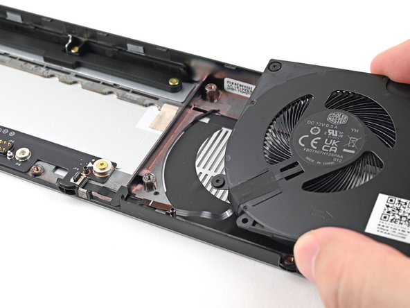

  15. Use one hand to press the right fan cable flat to the module. Use your other hand to pull the fan out of its housing, making sure to thread the cable through its slot. Use your other hand to pull the fan out of its housing, making sure to thread the cable through its slot.
    • Use one hand to press the right fan cable flat to the module.
    • Use your other hand to pull the fan out of its housing, making sure to thread the cable through its slot.

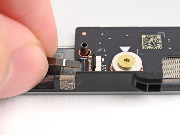

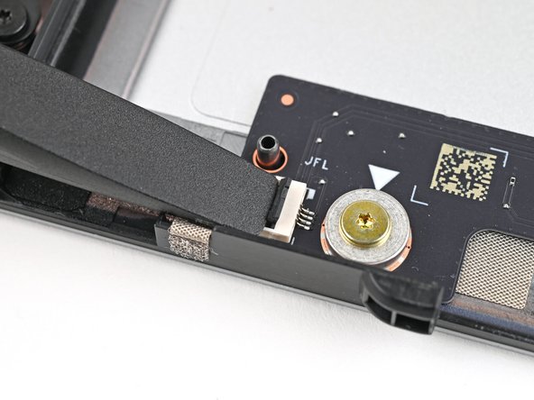

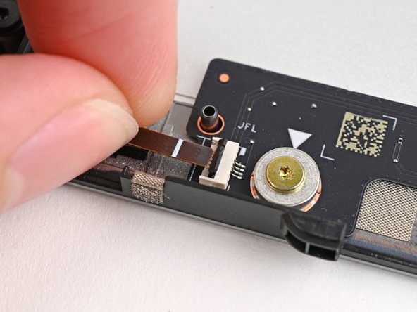

  16. Use the flat end of your Framework Screwdriver, or a clean fingernail, to lift up and release the locking tab on the left fan ZIF connector. Use your fingers to grip the brown pull tab and slide the left fan cable straight out of its socket. Use your fingers to grip the brown pull tab and slide the left fan cable straight out of its socket.
    • Use the flat end of your Framework Screwdriver, or a clean fingernail, to lift up and release the locking tab on the left fan ZIF connector.
    • Use your fingers to grip the brown pull tab and slide the left fan cable straight out of its socket.

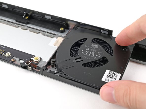

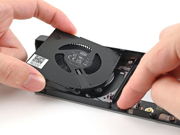

  18. Use one hand to press the left fan cable flat to the module. Use your other hand to pull the fan out of its housing, making sure to thread the cable through its slot. Use your other hand to pull the fan out of its housing, making sure to thread the cable through its slot.
    • Use one hand to press the left fan cable flat to the module.

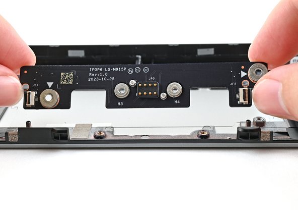

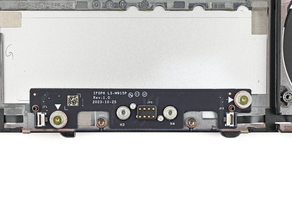

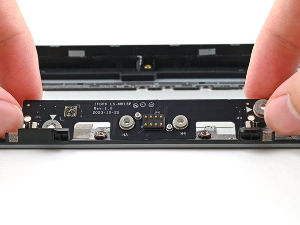

  19. Use your Framework Screwdriver to remove the two 3.6 mm‑long screws securing the Expansion Bay Shell Fan Board. Use your Framework Screwdriver to remove the two 3.6 mm‑long screws securing the Expansion Bay Shell Fan Board.
    • Use your Framework Screwdriver to remove the two 3.6 mm‑long screws securing the Expansion Bay Shell Fan Board.
  20. Use your fingers to lift the board straight off the Expansion Bay Shell and remove it. Use your fingers to lift the board straight off the Expansion Bay Shell and remove it. Use your fingers to lift the board straight off the Expansion Bay Shell and remove it.
    • Use your fingers to lift the board straight off the Expansion Bay Shell and remove it.

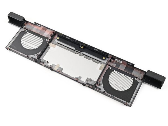

  21. Congratulations on completing disassembly! The remaining steps will show how to reassemble your Framework Laptop.

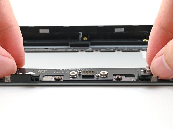

  22. Place the board straight on its alignment pegs on the Expansion Bay Shell. Place the board straight on its alignment pegs on the Expansion Bay Shell. Place the board straight on its alignment pegs on the Expansion Bay Shell.
    • Place the board straight on its alignment pegs on the Expansion Bay Shell.
  23. Use your Framework Screwdriver to install the two 3.6 mm‑long screws securing the Expansion Bay Shell Fan Board. Use your Framework Screwdriver to install the two 3.6 mm‑long screws securing the Expansion Bay Shell Fan Board.
    • Use your Framework Screwdriver to install the two 3.6 mm‑long screws securing the Expansion Bay Shell Fan Board.

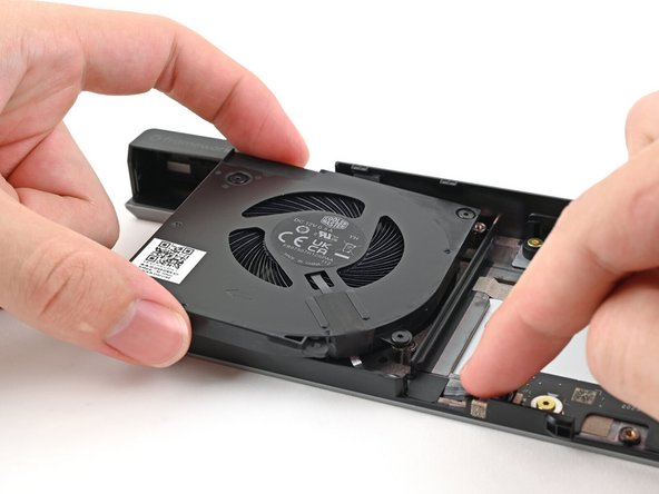

  24. Place the left fan onto the Expansion Bay Shell, making sure to thread the cable through its slot. Place the left fan onto the Expansion Bay Shell, making sure to thread the cable through its slot. Place the left fan onto the Expansion Bay Shell, making sure to thread the cable through its slot.
    • Place the left fan onto the Expansion Bay Shell, making sure to thread the cable through its slot.
  25. Use your Framework Screwdriver to tighten the four captive Torx T5 screws securing the left fan. Use your Framework Screwdriver to tighten the four captive Torx T5 screws securing the left fan.
    • Use your Framework Screwdriver to tighten the four captive Torx T5 screws securing the left fan.
  26. Use your fingers to grip the brown pull tab and slide the left fan cable straight into its socket. Use the flat end of your Framework Screwdriver, or a clean fingernail, to press down the locking tab on the left fan ZIF connector. Use the flat end of your Framework Screwdriver, or a clean fingernail, to press down the locking tab on the left fan ZIF connector.
    • Use your fingers to grip the brown pull tab and slide the left fan cable straight into its socket.
    • Use the flat end of your Framework Screwdriver, or a clean fingernail, to press down the locking tab on the left fan ZIF connector.
  27. Place the right fan onto the Expansion Bay Shell, making sure to thread the cable through its slot. Place the right fan onto the Expansion Bay Shell, making sure to thread the cable through its slot. Place the right fan onto the Expansion Bay Shell, making sure to thread the cable through its slot.
    • Place the right fan onto the Expansion Bay Shell, making sure to thread the cable through its slot.
  28. Use your Framework Screwdriver to tighten the four captive Torx T5 screws securing the right fan. Use your Framework Screwdriver to tighten the four captive Torx T5 screws securing the right fan.
    • Use your Framework Screwdriver to tighten the four captive Torx T5 screws securing the right fan.
  29. Use your fingers to grip the brown pull tab and slide the right fan cable straight into its socket. Use the flat end of your Framework Screwdriver, or a clean fingernail, to press down the locking tab on the right fan ZIF connector. Use the flat end of your Framework Screwdriver, or a clean fingernail, to press down the locking tab on the right fan ZIF connector.
    • Use your fingers to grip the brown pull tab and slide the right fan cable straight into its socket.
    • Use the flat end of your Framework Screwdriver, or a clean fingernail, to press down the locking tab on the right fan ZIF connector.
  30. Align the Expansion Bay Module with its slot in the laptop. Check that the module sits evenly with the rail on the outside edges of the slot.
  31. While keeping the module level with the laptop, slide it into its slot. The module should slide in easily. If you feel any resistance, pull the module out and realign it. You should hear an audible "click" when the module's clips snap into place.
    • While keeping the module level with the laptop, slide it into its slot.
    • The module should slide in easily. If you feel any resistance, pull the module out and realign it.
    • You should hear an audible "click" when the module's clips snap into place.

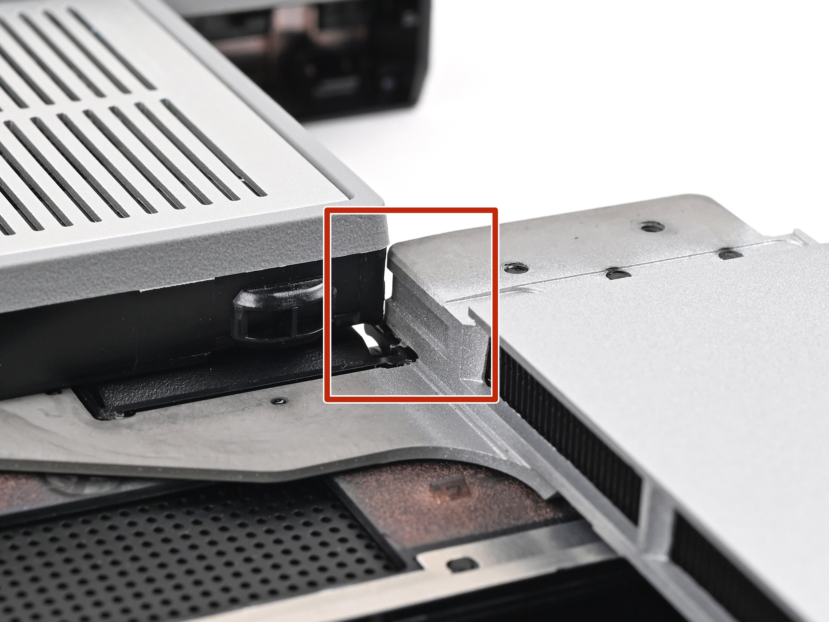

  32. While keeping the shell level with the laptop, slide it into its slot. The shell should slide in easily. If you feel any resistance, pull the module out and realign it. You should hear an audible "click" when the shell's clips snap into place.
    • While keeping the shell level with the laptop, slide it into its slot.
    • The shell should slide in easily. If you feel any resistance, pull the module out and realign it.
    • You should hear an audible "click" when the shell's clips snap into place.
    • This example shows inserting the Expansion Bay Shell.

  35. Place the interposer over its spot between the Mainboard and the Expansion Bay. Depending on if you're installing a Graphics Module or the Expansion Bay Shell, the interposer should be oriented so either rubber grommets or metal tabs cover the Expansion Bay screws.
    • Place the interposer over its spot between the Mainboard and the Expansion Bay.
    • Depending on if you're installing a Graphics Module or the Expansion Bay Shell, the interposer should be oriented so either rubber grommets or metal tabs cover the Expansion Bay screws.
  36. If you have the Graphics Module installed, your interposer will have four screws. If you have the Expansion Bay Shell installed, you'll have three screws instead. If you have the Graphics Module, use your Framework Screwdriver to tighten the four captive T5 Torx screws securing the interposer. If you have the Expansion Bay Shell, use your Framework Screwdriver to tighten the three captive T5 Torx screws securing the interposer.
    • If you have the Graphics Module, use your Framework Screwdriver to tighten the four captive T5 Torx screws securing the interposer.
    • If you have the Expansion Bay Shell, use your Framework Screwdriver to tighten the three captive T5 Torx screws securing the interposer.
    • Close the interposer door.

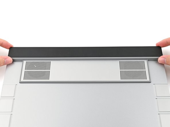

  37. Your Input Module(s) might be different, but the procedure to remove them is the same. Align the top edge of the Input Module with the top edge of the laptop. Lay the Input Module on the laptop and let the magnets pull the keyboard into place
  38. Align the top edge of the keyboard with the top edge of the laptop. Lay the keyboard on the laptop and let the magnets pull the keyboard into place Make sure the keyboard is seated properly on its alignment pegs and sits flush with the edges of the laptop.
  39. Place the Touchpad Module flat on its cutout so its clips are properly aligned. Press the Touchpad Module down and slide it into place so it lines up evenly with the bottom edge of the laptop.
  40. Place the Touchpad Spacer over its spot on the laptop with the bottom edge overhanging slightly. Slide the Touchpad Spacer towards the top of the laptop to secure it. Repeat the same procedure for the other Touchpad Spacer.
  41. Push the Input Module latches back into place to lock them. Push the Input Module latches back into place to lock them. Push the Input Module latches back into place to lock them.
