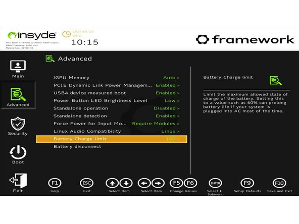

  2. Use the arrow keys to navigate to the advanced menu, and go to the bottom of the list.
    • Use the arrow keys to navigate to the advanced menu, and go to the bottom of the list.
    • Go to the line that says "Battery Charge Limit" and change the value to "90" and press "Enter".
    • Press F10 to "Save & Exit" and the device will reboot itself.

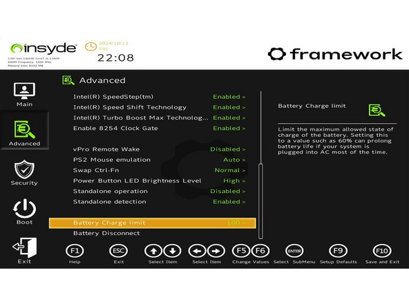

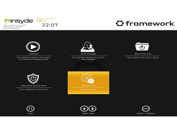

  3. Using the Arrow Keys, navigate to "Setup Utility" and press "Enter". Navigate to the "Advanced" tab on the left and go down to the option that says "Battery Charge Limit".
    • Using the Arrow Keys, navigate to "Setup Utility" and press "Enter".
    • Navigate to the "Advanced" tab on the left and go down to the option that says "Battery Charge Limit".
    • Change this value to "90" and press "Enter".

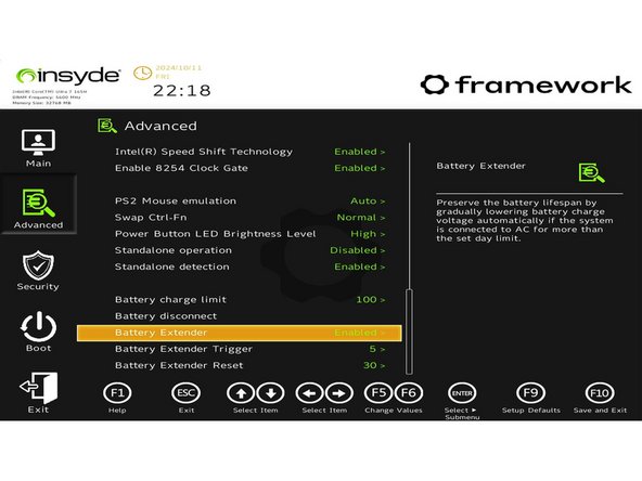

  4. Make sure you are on BIOS 3.04. Once you are on this BIOS, this is enabled by default. Using the Arrow Keys, navigate to "Setup Utility" and press "Enter".
    • Make sure you are on BIOS 3.04. Once you are on this BIOS, this is enabled by default.
    • Navigate to the "Advanced" tab on the left and go down to the option that says "Battery Extender".
    • Change this value to "Enabled" and press "Enter".

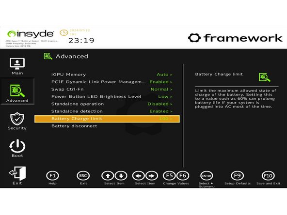

  5. Using the Arrow Keys, navigate to "Setup Utility" and press "Enter". Navigate to the "Advanced" tab on the left and go down to the option that says "Battery Charge Limit".
  6. Using the Arrow Keys, navigate to "Setup Utility" and press "Enter". Navigate to the "Advanced" tab on the left and go down to the option that says "Battery Charge Limit".
