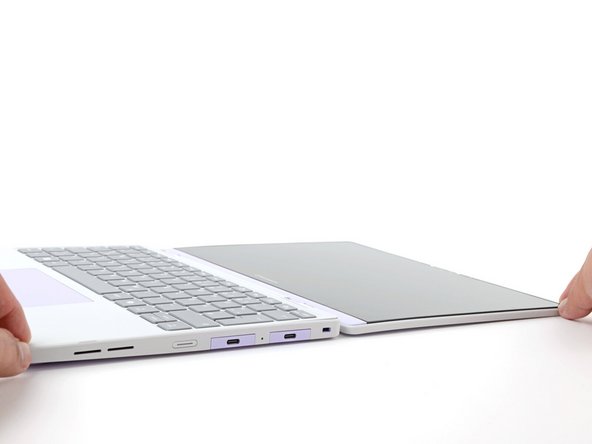

  2. Open the laptop lid so that both the screen and the base lie flat on your work surface. Open the laptop lid so that both the screen and the base lie flat on your work surface.

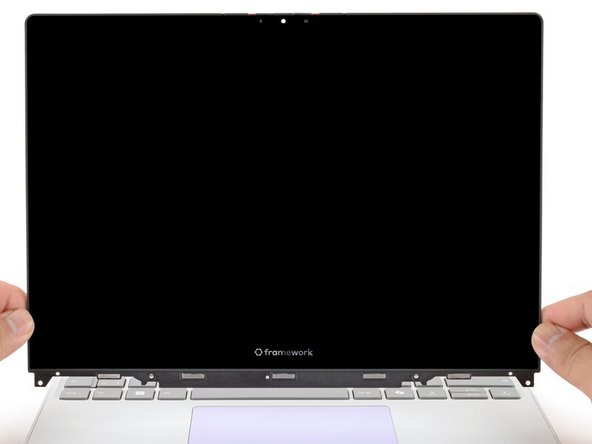

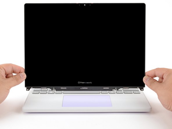

  8. Use your fingers to lift the top edge of the display from the Top Cover. Use your fingers to lift the top edge of the display from the Top Cover.
    • Use your fingers to lift the top edge of the display from the Top Cover.

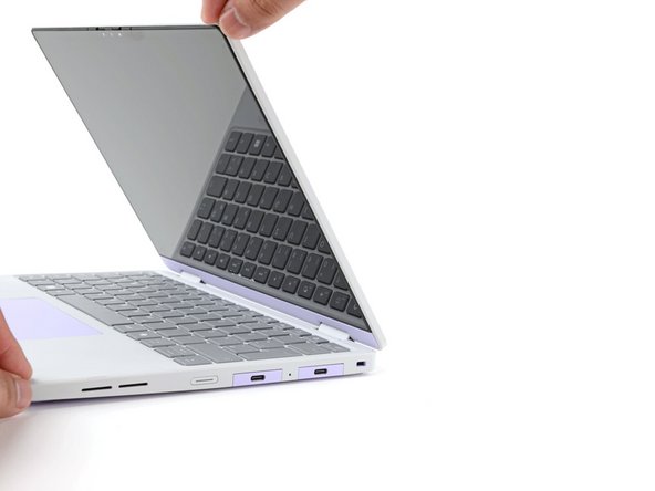

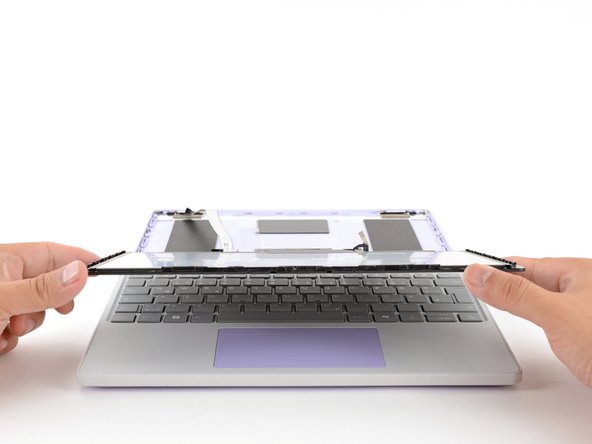

  9. Use your fingers to carefully swing the display over so it lies on top of the keyboard. Use your fingers to carefully swing the display over so it lies on top of the keyboard. Use your fingers to carefully swing the display over so it lies on top of the keyboard.
    • Use your fingers to carefully swing the display over so it lies on top of the keyboard.

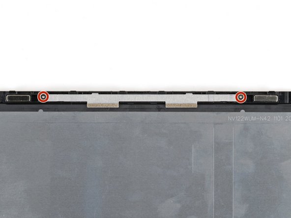

  10. Use your Framework Screwdriver to remove the two 3.3 mm‑long T5 Torx screws securing the webcam bracket on the top edge behind the display.
    • Use your Framework Screwdriver to remove the two 3.3 mm‑long T5 Torx screws securing the webcam bracket on the top edge behind the display.
    • These screws are not captive. Store them in a safe location for reassembly.

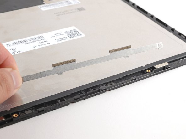

  11. Lift and remove the webcam bracket. Lift and remove the webcam bracket.
    • Lift and remove the webcam bracket.

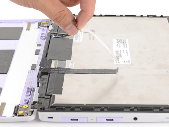

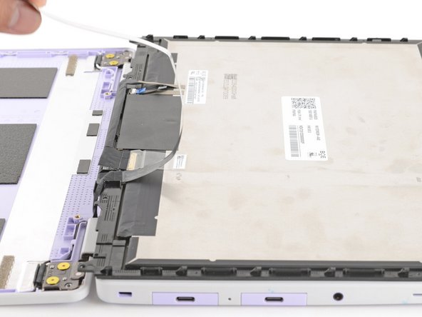

  15. The webcam cable is lightly adhered to the display. Grab the webcam cable with your fingers and slowly peel it away from the display. Carefully move the cable off of the display.
    • The webcam cable is lightly adhered to the display.
    • Grab the webcam cable with your fingers and slowly peel it away from the display.
    • Carefully move the cable off of the display.

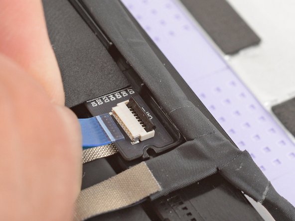

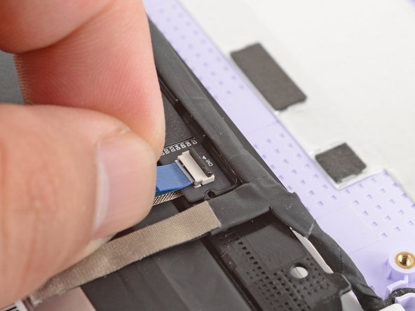

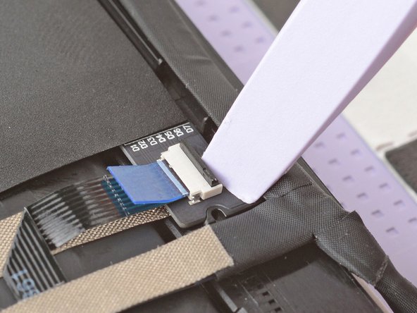

  16. Use the flat end of your Framework Screwdriver or a fingernail to gently pry up the locking tab on the touch control ZIF connector near the hinge edge of the display. Use your fingers to grab the touch control cable by the blue tab and slide the cable out of the connector. Use your fingers to grab the touch control cable by the blue tab and slide the cable out of the connector.
    • Use the flat end of your Framework Screwdriver or a fingernail to gently pry up the locking tab on the touch control ZIF connector near the hinge edge of the display.
    • Use your fingers to grab the touch control cable by the blue tab and slide the cable out of the connector.

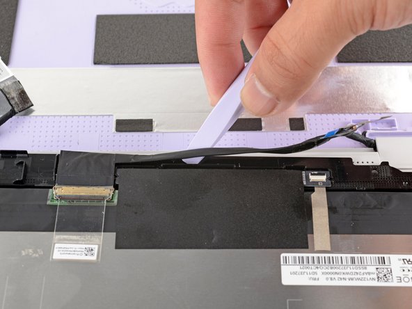

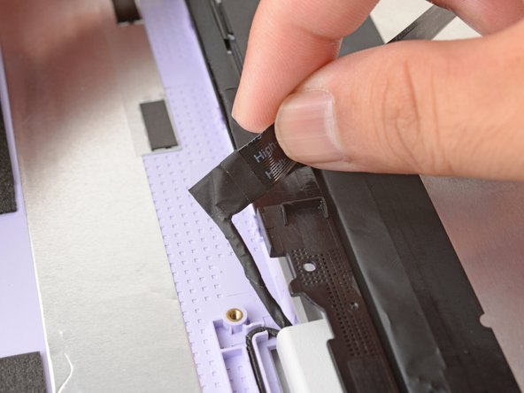

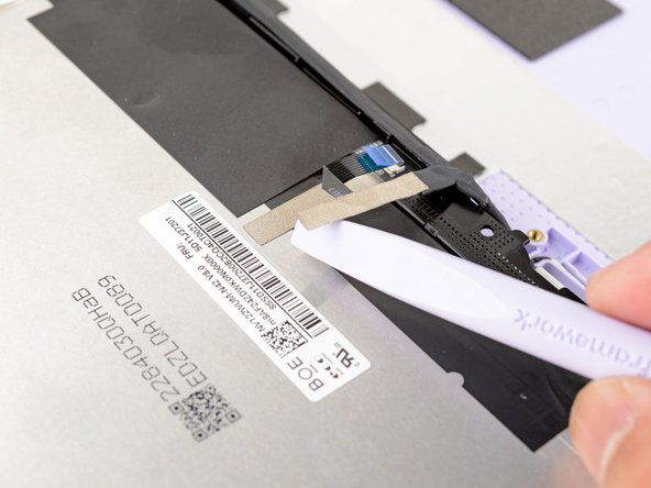

  17. Slide the flat end of your Framework Screwdriver under the grounding tape securing the display cable. Lift slowly to separate the tape from the display. Keep this tape clean and intact during your repair. You'll use it to attach the cable during reassembly.
    • Slide the flat end of your Framework Screwdriver under the grounding tape securing the display cable.
    • Lift slowly to separate the tape from the display.
    • Keep this tape clean and intact during your repair. You'll use it to attach the cable during reassembly.

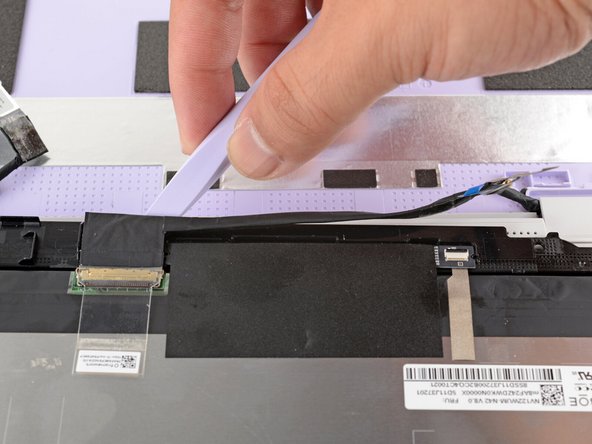

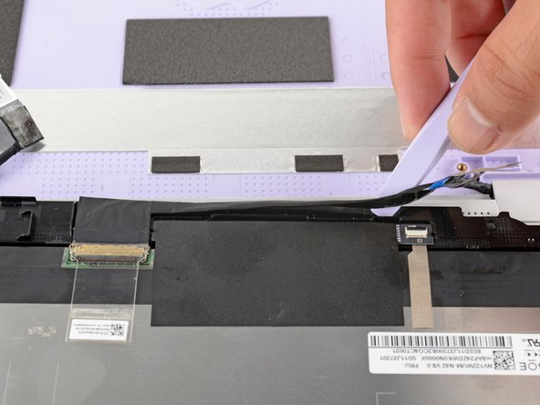

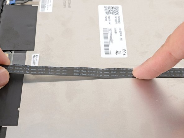

  18. The display cable is lightly adhered to the bottom edge of the display. Slide the flat end of your Framework Screwdriver under the length of the display cable to separate it from the display. Slide the flat end of your Framework Screwdriver under the length of the display cable to separate it from the display.
    • The display cable is lightly adhered to the bottom edge of the display.
    • Slide the flat end of your Framework Screwdriver under the length of the display cable to separate it from the display.

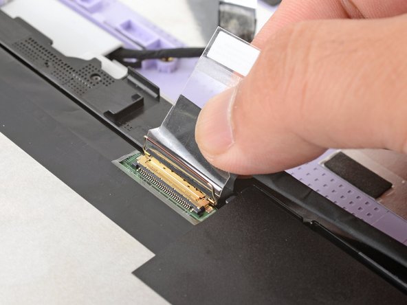

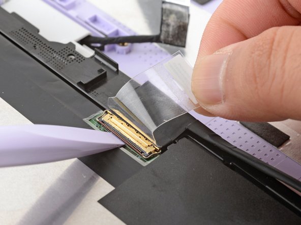

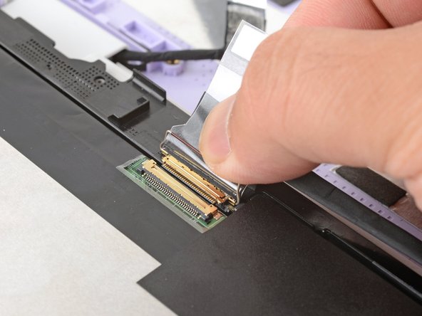

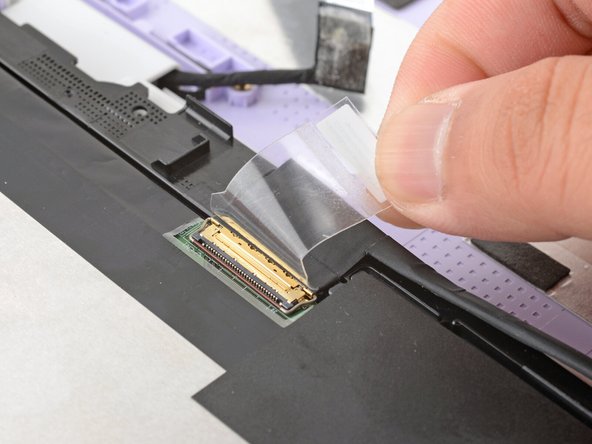

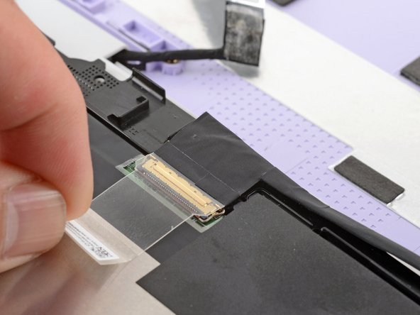

  19. Use your fingers to peel up the clear tab covering the display cable connector. Use your fingers to peel up the clear tab covering the display cable connector.
    • Use your fingers to peel up the clear tab covering the display cable connector.

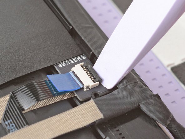

  20. Use the flat end of your Framework Screwdriver to flip up the locking bar around the display connector. Use the flat end of your Framework Screwdriver to flip up the locking bar around the display connector.
    • Use the flat end of your Framework Screwdriver to flip up the locking bar around the display connector.

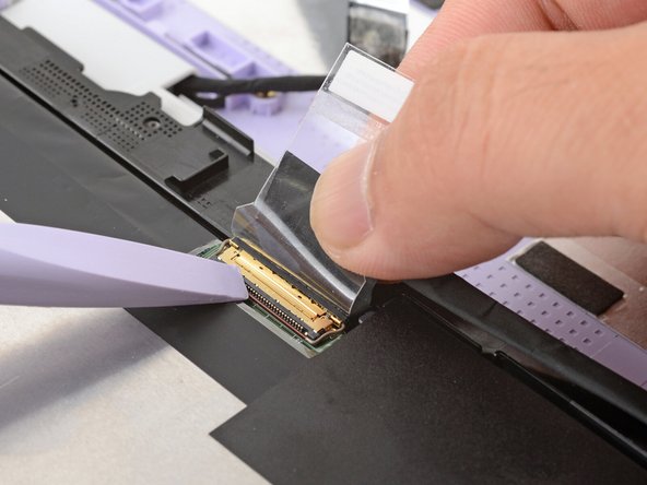

  21. Make sure the locking bar doesn't fall back in place while you disconnect the display cable. Grasp the display cable near the connector and slide it out of the connector.
    • Make sure the locking bar doesn't fall back in place while you disconnect the display cable.
    • Grasp the display cable near the connector and slide it out of the connector.
    • If you have trouble getting the cable to slide out, gently wiggle it to loosen the connection.

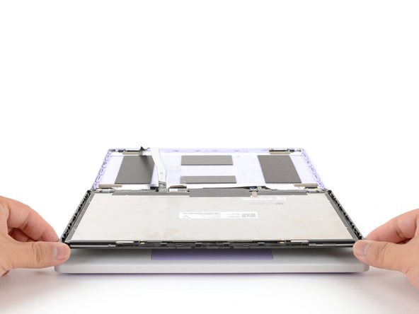

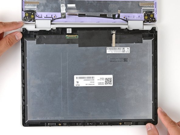

  22. Carefully lift and remove the display. Carefully lift and remove the display. Carefully lift and remove the display.
    • Carefully lift and remove the display.

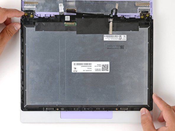

  25. Carefully lay the display screen-side down on top of the Input Cover. The edge with the webcam should lay near the touchpad edge. The Input Cover magnets will align the display to itself.
    • Carefully lay the display screen-side down on top of the Input Cover. The edge with the webcam should lay near the touchpad edge.
    • The Input Cover magnets will align the display to itself.
    • Use your fingers to slide the display off the Input Cover magnets towards the hinge edge so that the display cable can reach its connector.
  26. Use your fingers to grab the display cable by the clear tab and the locking bar. Align the display cable with its connector and slide it in until it's fully seated.
    • Use your fingers to grab the display cable by the clear tab and the locking bar.
    • Align the display cable with its connector and slide it in until it's fully seated.
  27. Swing the locking bar down over the connector. If the locking bar can't swing all the way down around the connector, you'll need to insert the cable deeper into the connector. Lay the clear tab over the connector and press it onto the display.
    • Swing the locking bar down over the connector.
    • If the locking bar can't swing all the way down around the connector, you'll need to insert the cable deeper into the connector.
    • Lay the clear tab over the connector and press it onto the display.

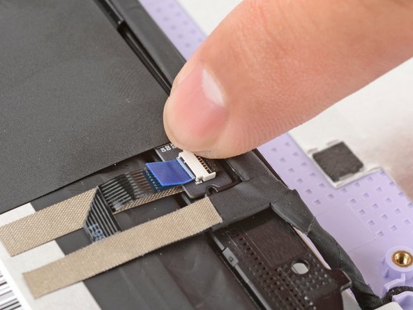

  28. Slide the touch control cable into the ZIF connector up to the printed line on the cable. Use your finger to flip down and gently press the locking tab in place.
    • Slide the touch control cable into the ZIF connector up to the printed line on the cable.
    • Use your finger to flip down and gently press the locking tab in place.

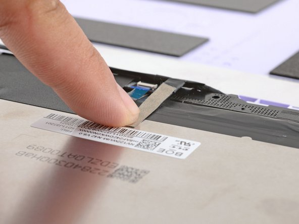

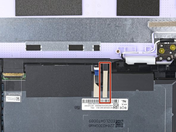

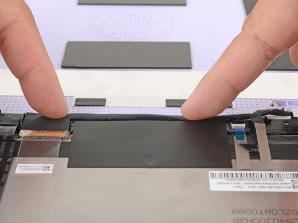

  29. Use your finger to press the display cable grounding tape onto the metal back of the display. Use your fingers to press the display cable onto the display.
    • Use your finger to press the display cable grounding tape onto the metal back of the display.
    • Use your fingers to press the display cable onto the display.
  30. Use your fingers to press the webcam cable onto the display.
    • Use your fingers to press the webcam cable onto the display.
