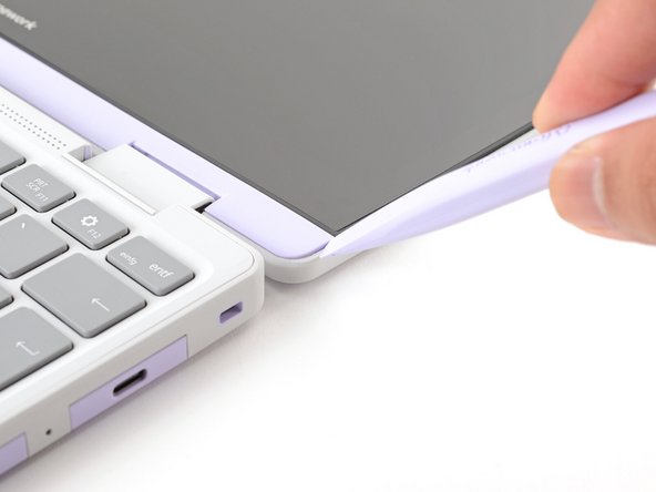

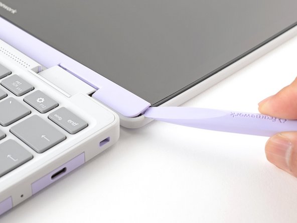

  2. The Display Cover is held in place with magnets along the top edge and clips along the remaining edges. Use the flat end of your Framework Screwdriver to pry up the right edge of the Display Cover.
    • The Display Cover is held in place with magnets along the top edge and clips along the remaining edges.
    • Use the flat end of your Framework Screwdriver to pry up the right edge of the Display Cover.
  3. Slide your fingers under the top edge of the Display Cover to release it from the laptop. Slide your fingers under the top edge of the Display Cover to release it from the laptop. Slide your fingers under the top edge of the Display Cover to release it from the laptop.
    • Slide your fingers under the top edge of the Display Cover to release it from the laptop.

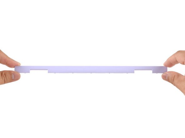

  4. Remove the Display Cover. Remove the Display Cover.
    • Remove the Display Cover.
