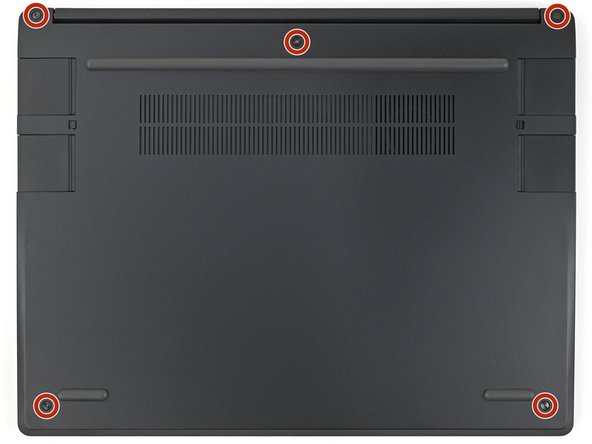

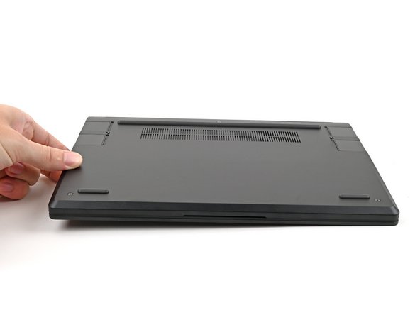

  2. Use your Framework Screwdriver to loosen the five captive T5 Torx screws securing the Input Cover. Use your Framework Screwdriver to loosen the five captive T5 Torx screws securing the Input Cover.

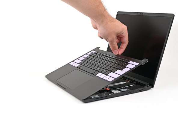

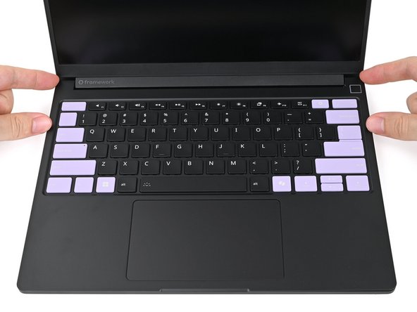

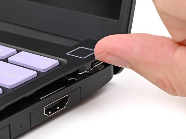

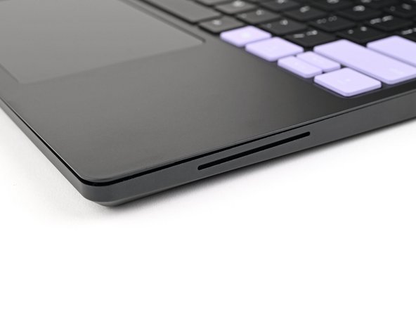

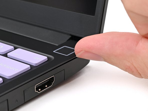

  3. Open the laptop. Use your fingers to lift the Input Cover up and release it from its magnets.
    • Open the laptop.
    • If you're having trouble lifting the Input Cover, you can leverage the gap at the bottom right corner to get your fingers fully under it.

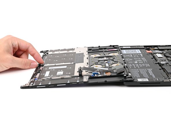

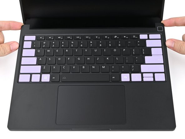

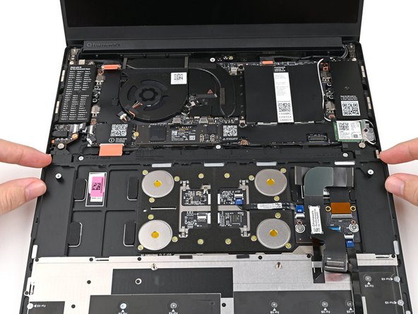

  4. Flip the top of the Input Cover so the keyboard is facing down. Rest the Input Cover over the Battery, making sure the Touchpad Cable isn't being strained.
    • Flip the top of the Input Cover so the keyboard is facing down.

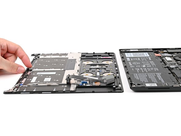

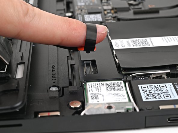

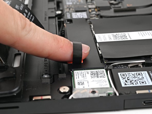

  5. Insert your finger into the Touchpad Cable press connector loop. Lift up to disconnect the Touchpad Cable from the Mainboard.

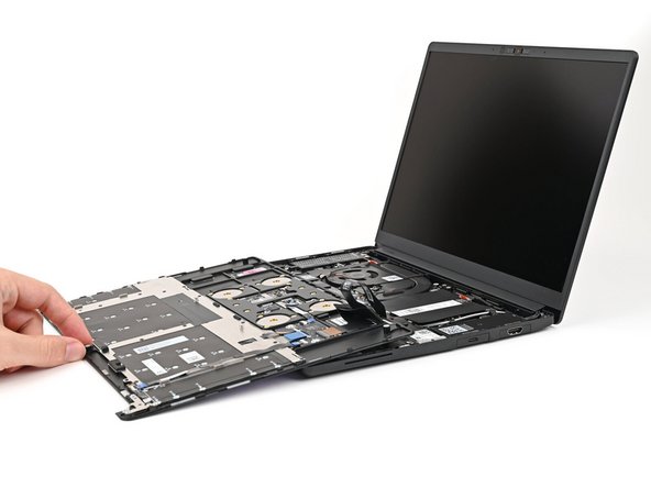

  6. Remove the Input Cover. Remove the Input Cover.
    • Remove the Input Cover.

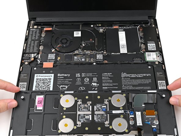

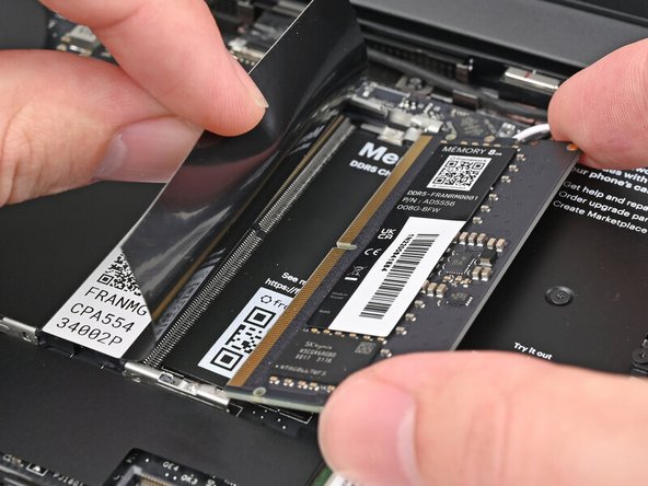

  7. While holding up the black flap covering the left memory module, push the two metal arms on each side of the module outward until they disengage and the module pops up at a shallow angle. Slide the memory module out of its socket and remove it. Slide the memory module out of its socket and remove it.
    • While holding up the black flap covering the left memory module, push the two metal arms on each side of the module outward until they disengage and the module pops up at a shallow angle.
    • Slide the memory module out of its socket and remove it.
  8. Repeat the previous step for the right module. Repeat the previous step for the right module. Repeat the previous step for the right module.
    • Repeat the previous step for the right module.

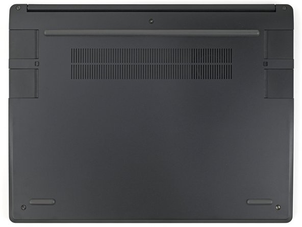

  16. Close the laptop and flip it over.
  17. Use your Framework Screwdriver to tighten the five captive T5 Torx screws securing the Input Cover. Don't overtighten the screws—just make sure they're snug.
