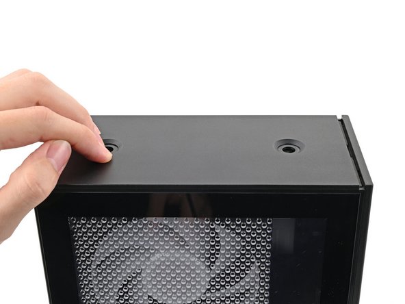

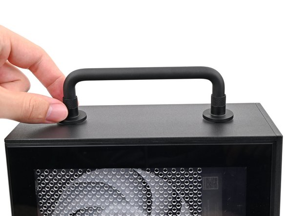

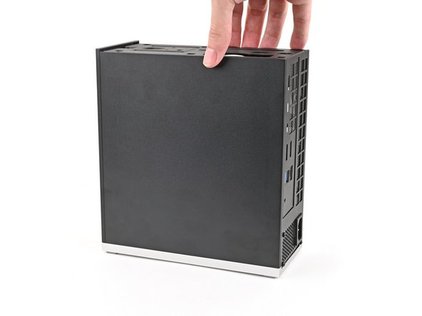

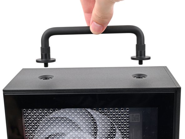

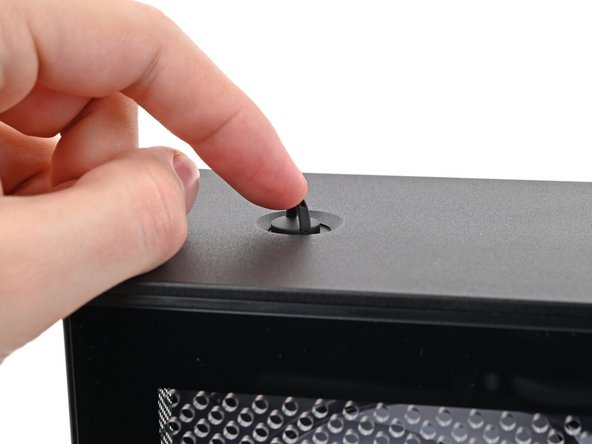

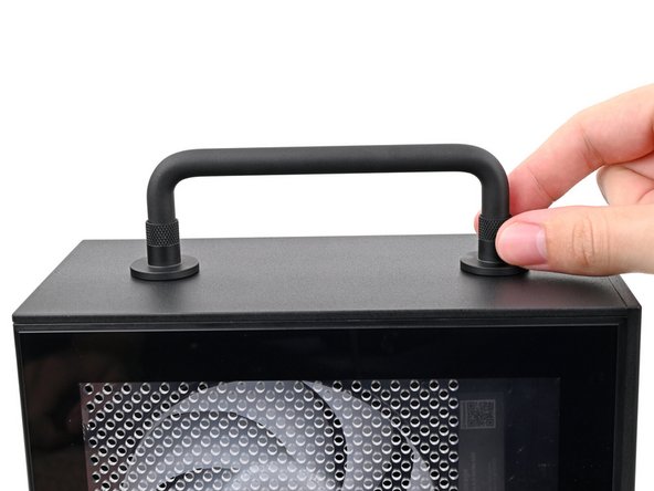

    • Remove the Handle.

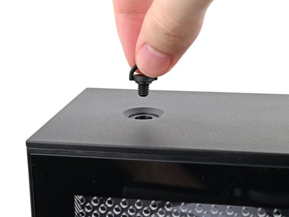

    • Remove the Top Panel screw.

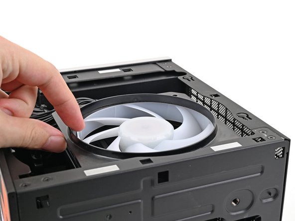

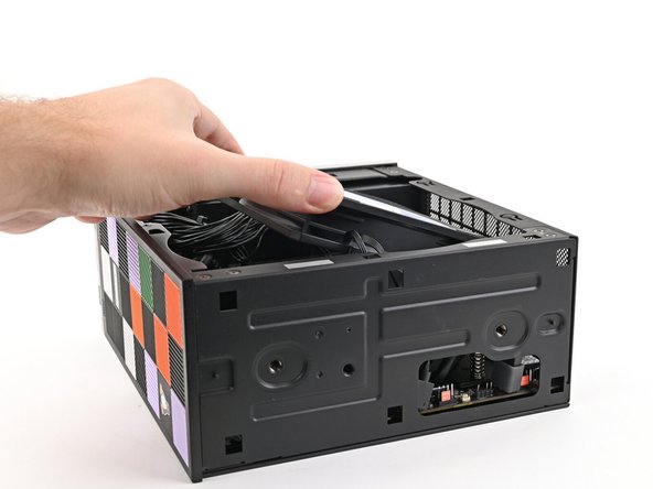

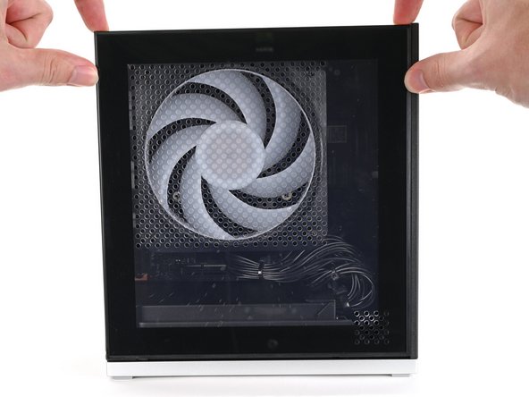

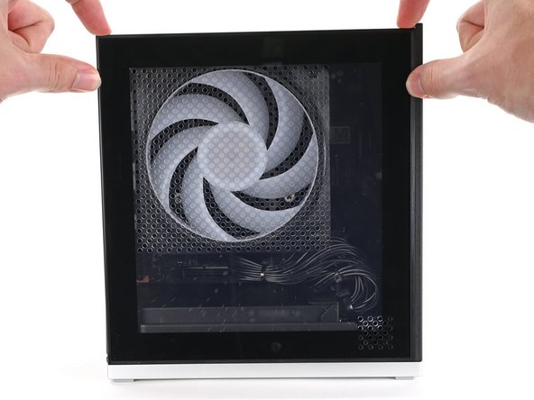

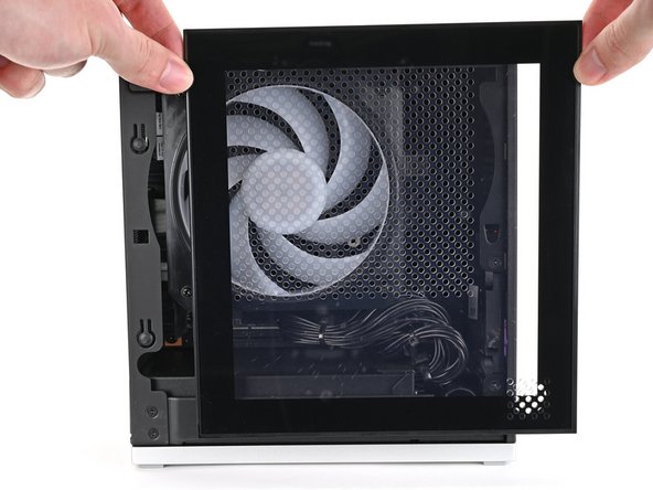

  7. Use your fingers to grip the top of the Left Panel and slide it upward to release its clips. Remove the Left Panel. Remove the Left Panel.
    • Remove the Left Panel.

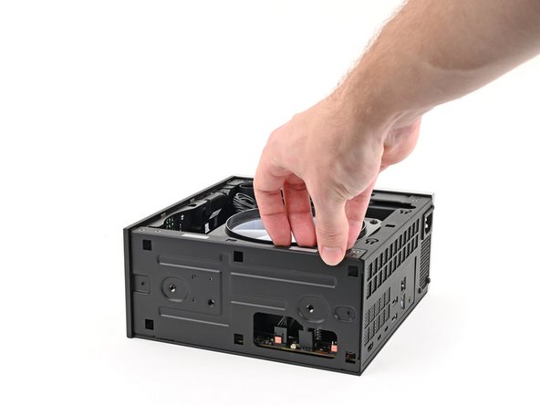

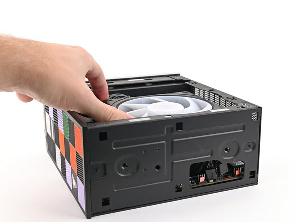

  8. Lay down the Desktop on its side so the fan is facing upward. Lay down the Desktop on its side so the fan is facing upward.
    • Lay down the Desktop on its side so the fan is facing upward.

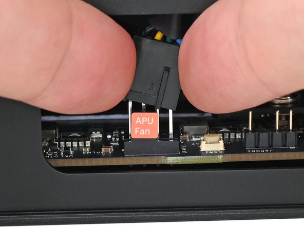

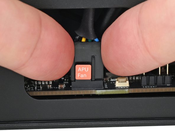

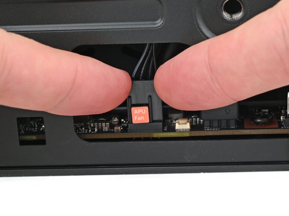

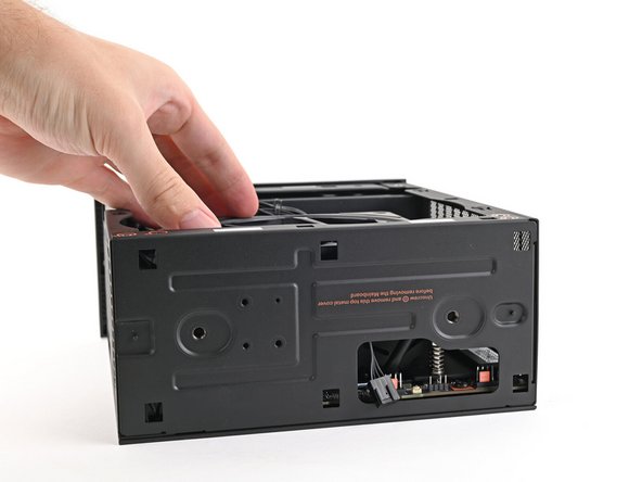

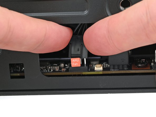

  9. Use your fingers to lift the APU fan cable connector off its four‑pronged socket on the Mainboard. Use your fingers to lift the APU fan cable connector off its four‑pronged socket on the Mainboard.
    • Use your fingers to lift the APU fan cable connector off its four‑pronged socket on the Mainboard.

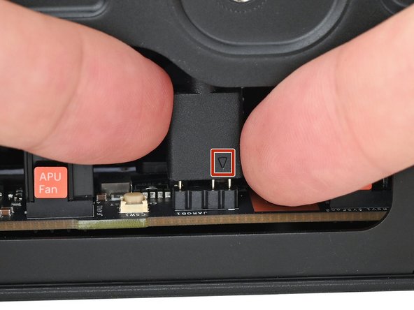

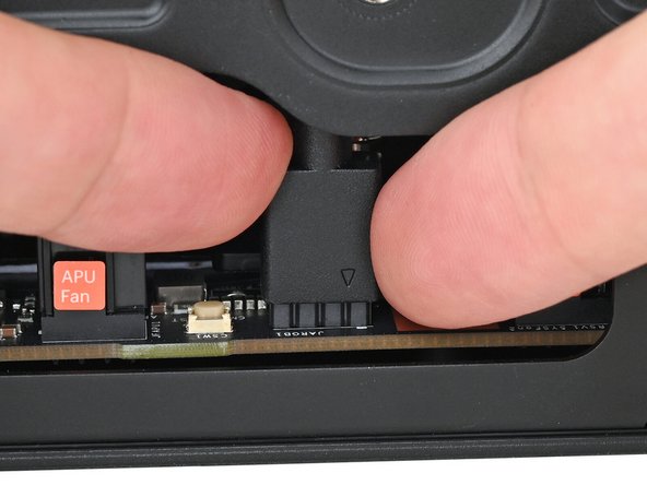

  10. If you aren't using an RGB fan, then skip this step. Use your fingers to lift the fan RGB cable connector off its three‑pronged socket on the Mainboard.
    • Use your fingers to lift the fan RGB cable connector off its three‑pronged socket on the Mainboard.

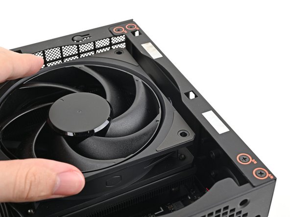

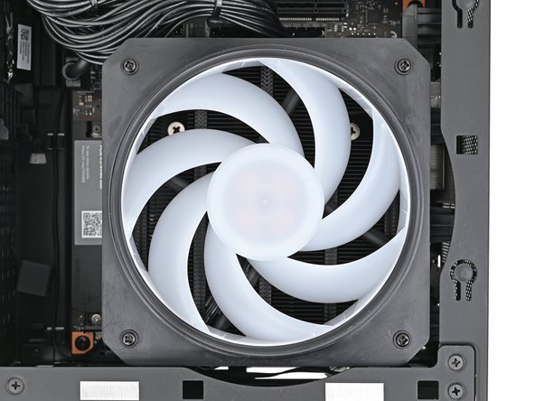

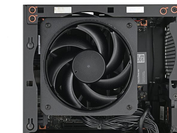

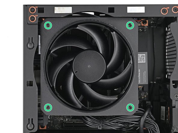

  11. Use your Framework Desktop Screwdriver to remove the four 27.3 mm‑long Phillips screws securing the CPU fan and fan duct. Use your Framework Desktop Screwdriver to remove the four 27.3 mm‑long Phillips screws securing the CPU fan and fan duct.
    • Use your Framework Desktop Screwdriver to remove the four 27.3 mm‑long Phillips screws securing the CPU fan and fan duct.

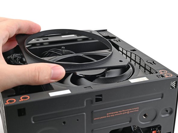

  12. Lift the fan duct off the fan and remove it. Lift the fan duct off the fan and remove it.
    • Lift the fan duct off the fan and remove it.

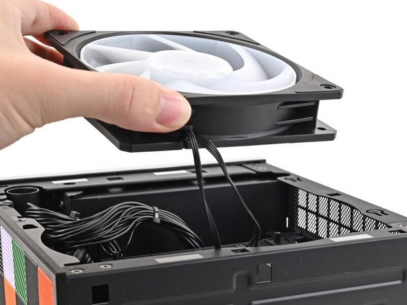

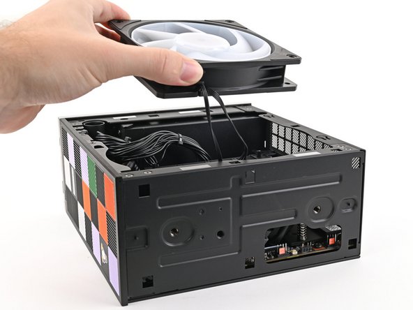

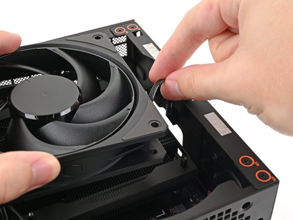

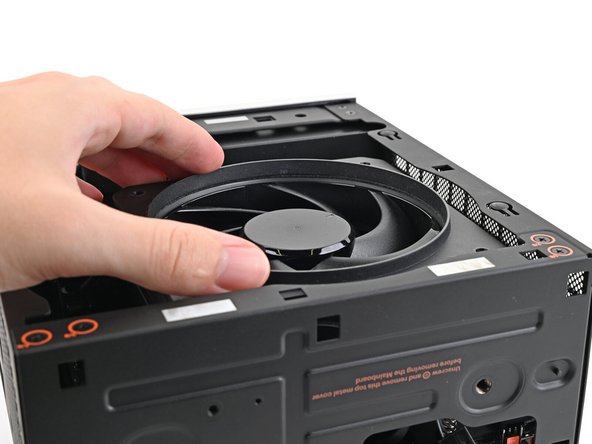

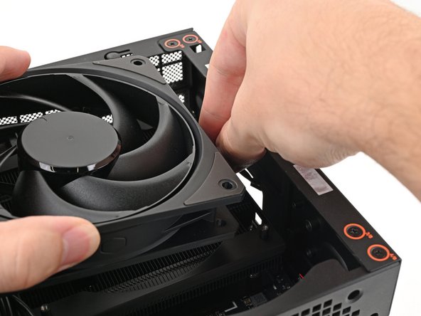

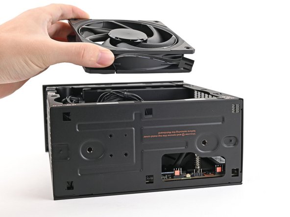

  13. Lift the fan out of the chassis, making sure the cables thread through the side of the heatsink. Lift the fan out of the chassis, making sure the cables thread through the side of the heatsink. Lift the fan out of the chassis, making sure the cables thread through the side of the heatsink.
    • Lift the fan out of the chassis, making sure the cables thread through the side of the heatsink.

  15. Orient the fan so its label is facing downward and the cable(s) is pointing towards the top of the computer. If your fan has an arrow indicating airflow direction, make sure it's pointed towards the heatsink.
    • Lay the fan on top of the heatsink, making sure the cables are routed so they poke out of the hole on the top of the computer.
  16. If the cables aren't routed properly, lift the fan up slightly and use your fingers to reposition the cables over the side of the heatsink. If you're installing an RGB fan, make sure the "male" end of the RGB cable is covered and set aside in the corner of the chassis. If you're installing an RGB fan, make sure the "male" end of the RGB cable is covered and set aside in the corner of the chassis.
    • If the cables aren't routed properly, lift the fan up slightly and use your fingers to reposition the cables over the side of the heatsink.
  17. Lay the fan duct on top of the fan with the lip facing upward. Align the screw holes on the fan duct with the ones on the fan.

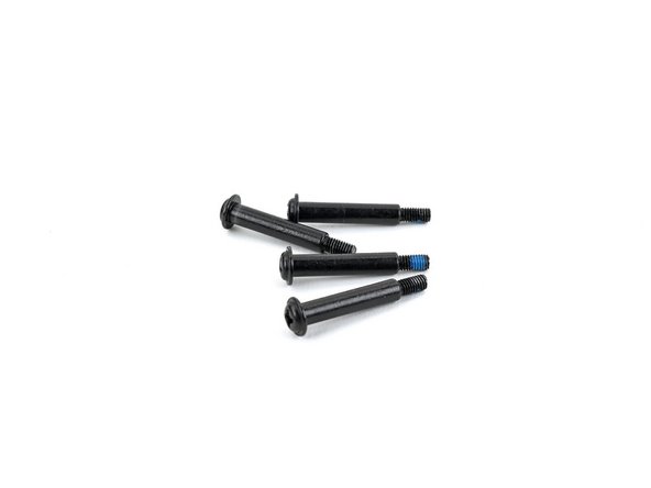

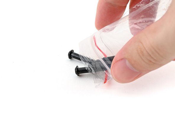

  18. (if new) Remove the fan screws from their packaging and make sure there are four screws total. (if new) Remove the fan screws from their packaging and make sure there are four screws total.
    • (if new) Remove the fan screws from their packaging and make sure there are four screws total.
  19. Use your Framework Desktop Screwdriver to install the four 27.3 mm‑long Phillips screws securing the CPU fan and fan duct. Use your Framework Desktop Screwdriver to install the four 27.3 mm‑long Phillips screws securing the CPU fan and fan duct.
    • Use your Framework Desktop Screwdriver to install the four 27.3 mm‑long Phillips screws securing the CPU fan and fan duct.

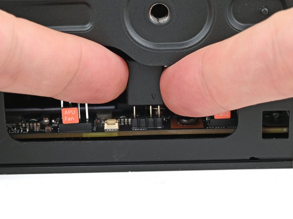

  20. Orient the main fan cable so its two vertical lines are facing you. Slide the main fan cable over the four-pronged connector labeled "APU Fan," making sure the orange label slots between the vertical lines.

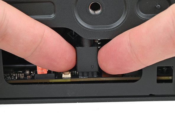

  21. If you aren't using an RGB fan, then skip this step. Orient the RGB cable so the arrow is facing you. Use your fingers to slide the RGB cable over the three pronged connector located to the right of the "APU Fan" connector.
    • Orient the RGB cable so the arrow is facing you.

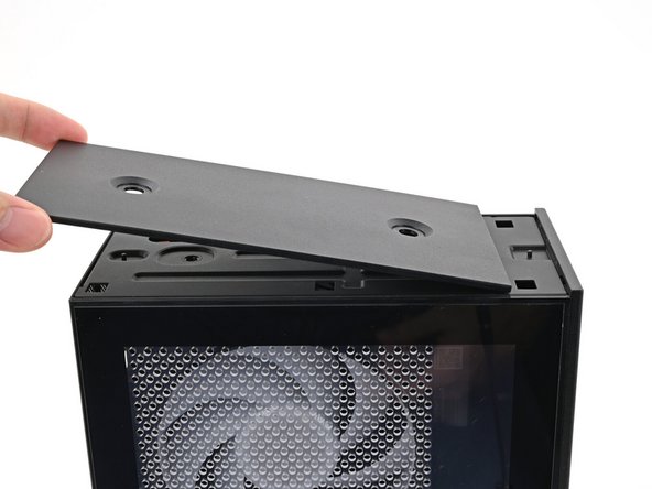

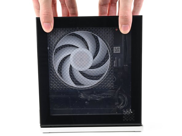

  22. Slide the Left Panel onto the left edge of the chassis and press it flat to ensure its clips are slotted into place. There should be a small gap between the bottom of the Left Panel and the silver base. Push the Left Panel towards the base of the computer to close the gap and engage the clips.

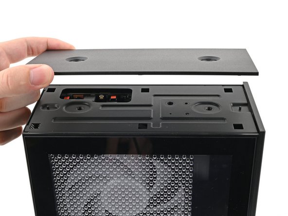

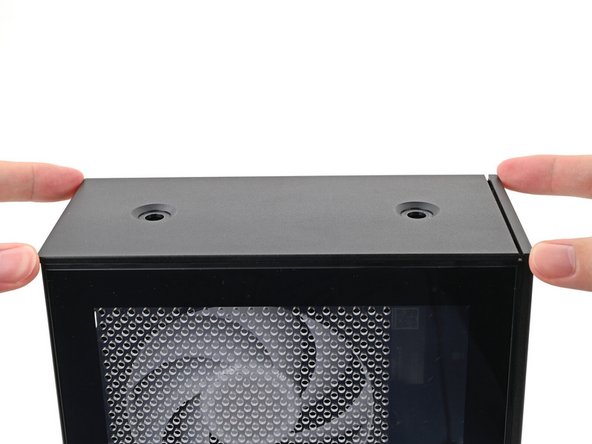

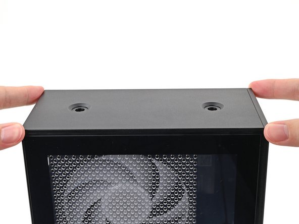

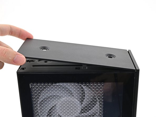

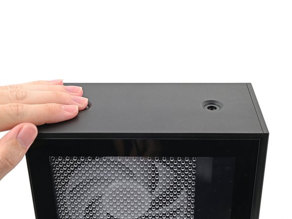

  23. Orient the Top Panel so its arrow is pointing towards the rear of the computer. While holding the Top Panel at a slight downward angle, slide it across the top of the chassis (from rear to front) until you feel its clips catch. There should be a small gap between the Top Panel and the front of the Desktop.
  24. While securing the computer with one hand, use the other hand to slide the Top Panel towards the front of the computer to close the gap and engage the clips. While securing the computer with one hand, use the other hand to slide the Top Panel towards the front of the computer to close the gap and engage the clips.

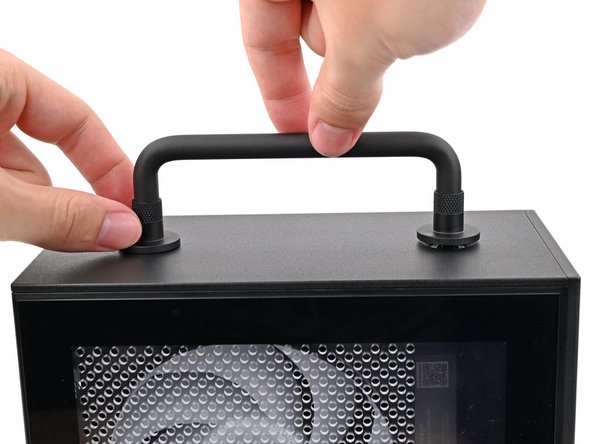

  25. If you're installing the Handle on your Desktop, follow this step. Otherwise, skip it. Place the Handle over the Top Panel screw holes.

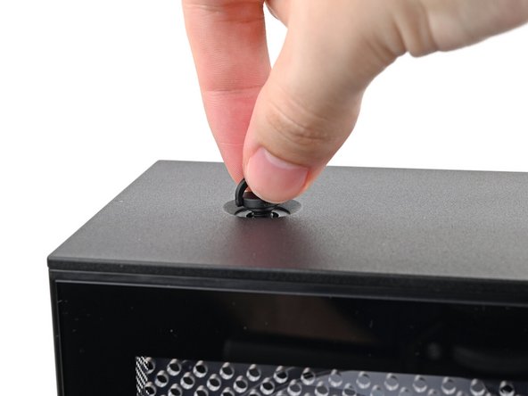

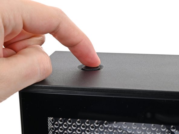

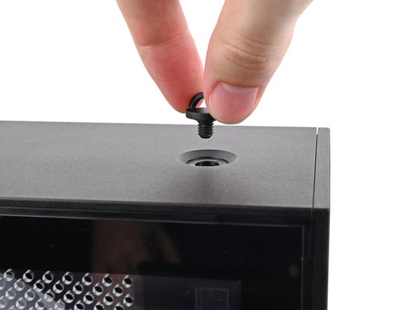

  26. Insert the top panel screw into its hole and twist clockwise until it feels snug. Insert the top panel screw into its hole and twist clockwise until it feels snug. Insert the top panel screw into its hole and twist clockwise until it feels snug.
  27. Repeat the same procedure for the other top panel screw. Repeat the same procedure for the other top panel screw. Repeat the same procedure for the other top panel screw.

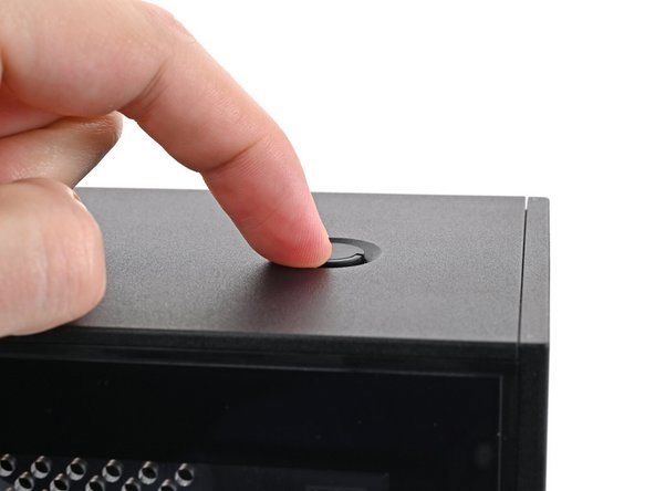

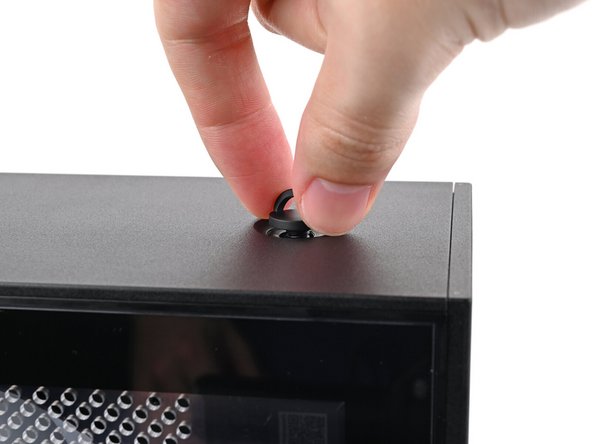

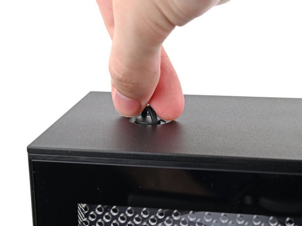

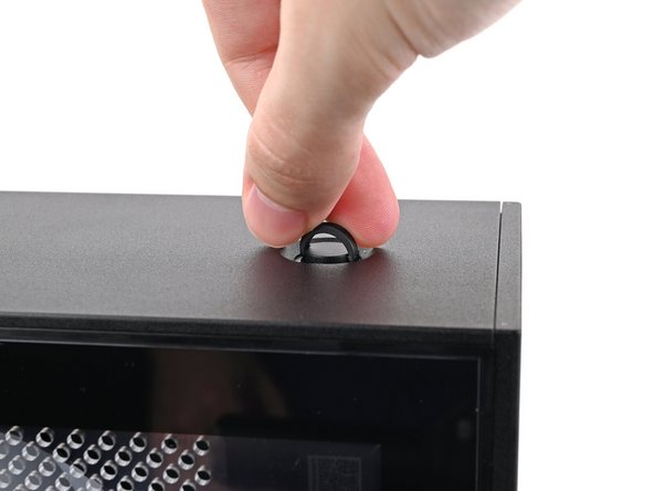

  28. Use your finger to close the two D-rings on the top panel screws. Use your finger to close the two D-rings on the top panel screws. Use your finger to close the two D-rings on the top panel screws.
