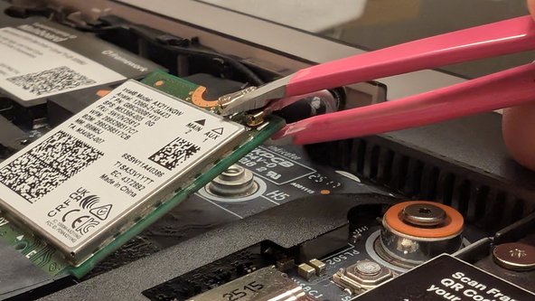

  45. Hold the Wi-Fi card down with your finger. Position the black antenna cable connector over the left Wi-Fi card's coaxial socket. Tweezers can help position the connector.
    • Hold the Wi-Fi card down with your finger.
    • Position the black antenna cable connector over the left Wi-Fi card's coaxial socket.
    • Repeat the procedure with the white antenna cable.
    I found it nearly impossible to get the connectors to stay when pushing them down with my fingers or the spudger end of the framework screwdriver tool.
    I succeeded when using the tweezers to squeeze the connector onto the card before insert card into the m.2 slot.
