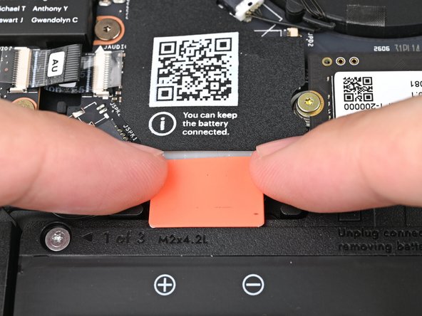

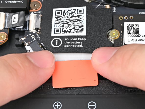

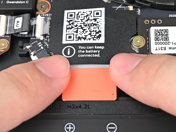

  7. When disconnecting the Battery, make sure you slide its connector straight out of its socket or else you risk bending the socket's pins. Use your fingers to grip the edges of the Battery connector and slide it straight out of its socket to disconnect the Battery.
    • When disconnecting the Battery, make sure you slide its connector straight out of its socket or else you risk bending the socket's pins.
    • Use your fingers to grip the edges of the Battery connector and slide it straight out of its socket to disconnect the Battery.

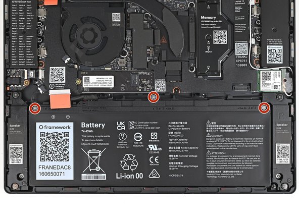

  8. Use your Framework Screwdriver to loosen the three captive T5 Torx screws securing the Battery. Use your Framework Screwdriver to loosen the three captive T5 Torx screws securing the Battery.
    • Use your Framework Screwdriver to loosen the three captive T5 Torx screws securing the Battery.

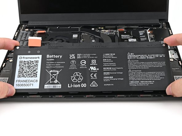

  9. Only handle the Battery by its plastic frame, making sure you don't bend or puncture it. Lift the Battery towards the top edge of the laptop to slide its plastic tabs out of the Bottom Cover.
    • Only handle the Battery by its plastic frame, making sure you don't bend or puncture it.
    • Lift the Battery towards the top edge of the laptop to slide its plastic tabs out of the Bottom Cover.
    • Remove the Battery.

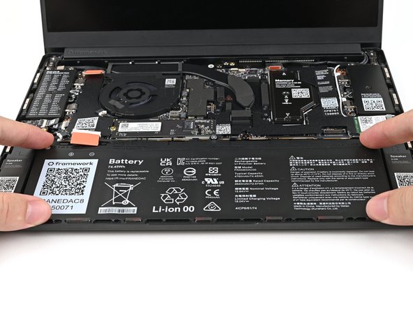

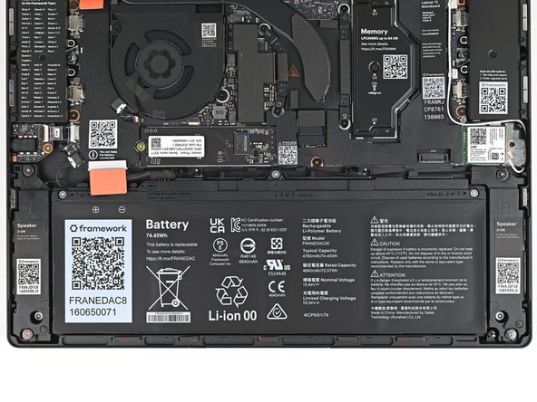

  11. Insert the Battery into its cutout, making sure its plastic tabs are slotted into the Bottom Cover. Insert the Battery into its cutout, making sure its plastic tabs are slotted into the Bottom Cover.
    • Insert the Battery into its cutout, making sure its plastic tabs are slotted into the Bottom Cover.
  12. Use your Framework Screwdriver to tighten the three captive T5 Torx screws securing the Battery. Use your Framework Screwdriver to tighten the three captive T5 Torx screws securing the Battery.
    • Use your Framework Screwdriver to tighten the three captive T5 Torx screws securing the Battery.

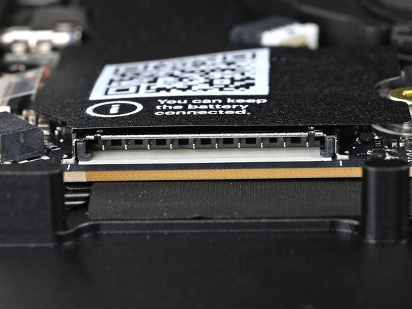

  13. Before continuing, check the pins on the Battery socket and make sure they aren't bent. If any of the pins are bent, reach out to Framework Support.
    • Before continuing, check the pins on the Battery socket and make sure they aren't bent.
    • If any of the pins are bent, reach out to Framework Support.

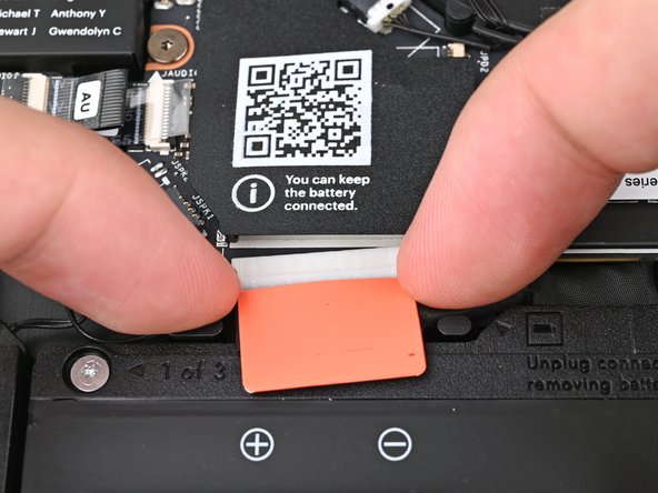

  14. Use your fingers to align the Battery connector with its socket and slide it straight in to reconnect the Battery. Use your fingers to align the Battery connector with its socket and slide it straight in to reconnect the Battery.
    • Use your fingers to align the Battery connector with its socket and slide it straight in to reconnect the Battery.
