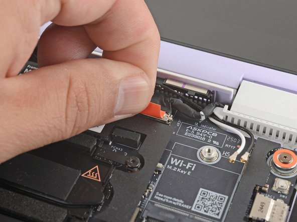

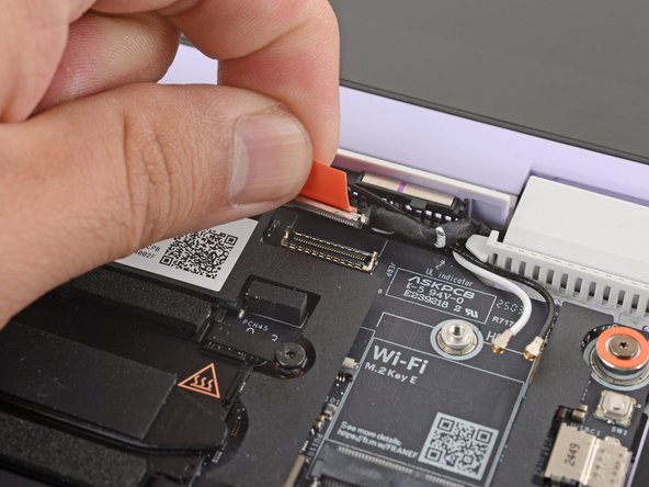

  18. The Wi-Fi card has two delicate coaxial cable connectors. Follow this step carefully to avoid damaging them. Press and hold the Wi-Fi card down with your finger. Slide the flat edge of your Framework Screwdriver under the white antenna cable, as close to the metal head as possible.
    • The Wi-Fi card has two delicate coaxial cable connectors. Follow this step carefully to avoid damaging them.
    • Press and hold the Wi-Fi card down with your finger.
    • Slide the flat edge of your Framework Screwdriver under the white antenna cable, as close to the metal head as possible.
    • Gently lift the connector straight up to disconnect the white antenna cable.
    • Repeat the procedure with the black antenna cable.

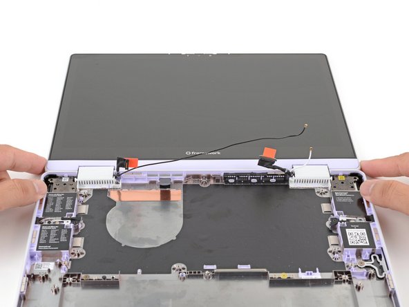

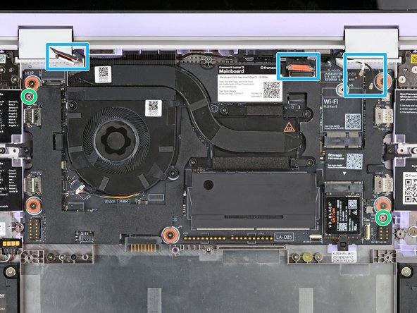

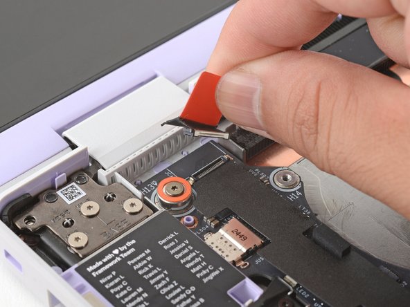

  20. Use your fingers to grab the orange tab on the webcam cable, located near the left hinge. Lift straight up to disconnect the cable.
    • Use your fingers to grab the orange tab on the webcam cable, located near the left hinge.
    • Lift straight up to disconnect the cable.

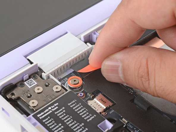

  21. Use your fingers to grab the orange tab on the display cable, located near the right hinge. Lift straight up to disconnect the cable.
    • Use your fingers to grab the orange tab on the display cable, located near the right hinge.

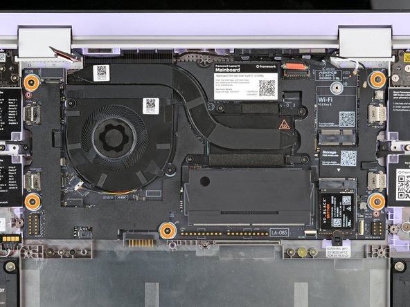

  22. Use your Framework Screwdriver to loosen the five captive T5 Torx screws securing the Mainboard.
    • Use your Framework Screwdriver to loosen the five captive T5 Torx screws securing the Mainboard.
    • These screws are also physically marked with an orange ring on the Mainboard.

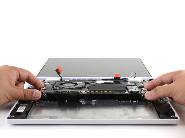

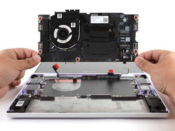

  23. Make sure you've removed all Expansion Cards. Installed cards will hold the Mainboard in place. Use your fingers to grab the Mainboard by its edges.
    • Make sure you've removed all Expansion Cards. Installed cards will hold the Mainboard in place.
    • Use your fingers to grab the Mainboard by its edges.
    • Lift and remove the Mainboard.

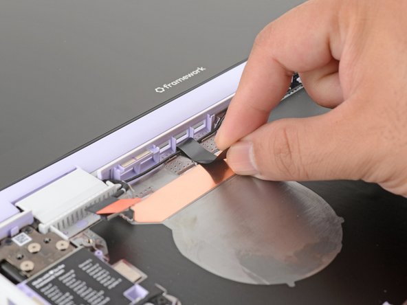

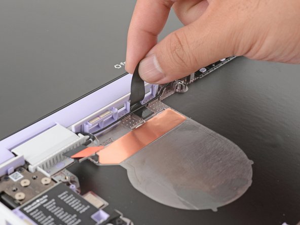

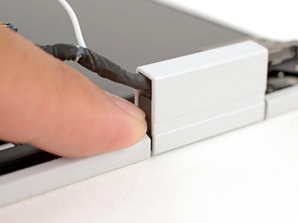

  24. Use your fingers to lift the black plastic loop securing the antenna cable, near the heat vents by the left hinge. Use your fingers to lift the black plastic loop securing the antenna cable, near the heat vents by the left hinge.
    • Use your fingers to lift the black plastic loop securing the antenna cable, near the heat vents by the left hinge.
  25. Use your fingers to lift and guide the antenna cable out of the frame channel. Use your fingers to lift and guide the antenna cable out of the frame channel.
    • Use your fingers to lift and guide the antenna cable out of the frame channel.
  26. Use your fingers to gently lift the webcam cable out of its plastic channel. Use your fingers to gently lift the webcam cable out of its plastic channel.
    • Use your fingers to gently lift the webcam cable out of its plastic channel.

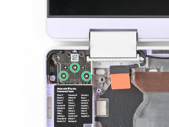

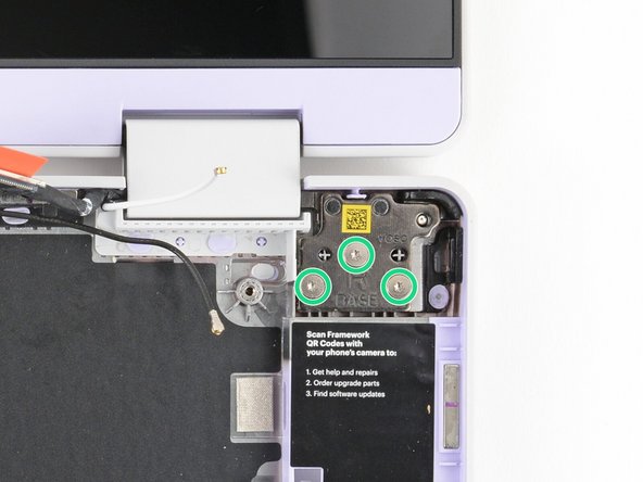

  27. Use your Framework Screwdriver to remove the six (three per hinge) 4.5 mm‑long T5 Torx screws securing the two hinges. These screws are not captive. Store them in a safe location for reassembly.
    • Use your Framework Screwdriver to remove the six (three per hinge) 4.5 mm‑long T5 Torx screws securing the two hinges.
    • These screws are not captive. Store them in a safe location for reassembly.

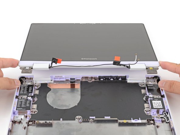

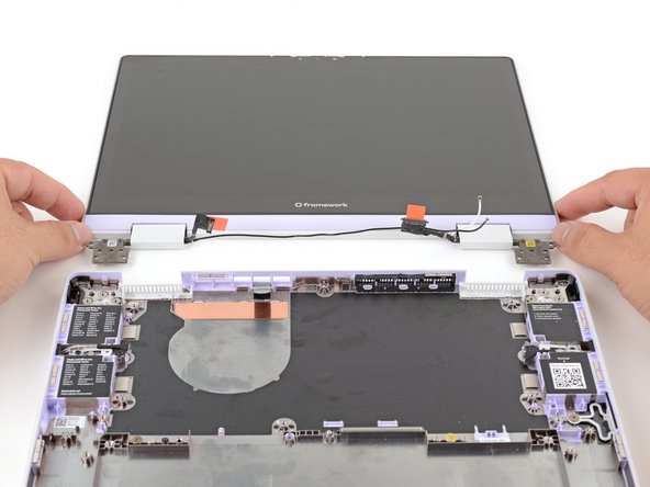

  28. Use your fingers to lift the hinges over the Bottom Cover lip. Separate the Top Cover from the Bottom Cover. Separate the Top Cover from the Bottom Cover.
    • Use your fingers to lift the hinges over the Bottom Cover lip.
    • Separate the Top Cover from the Bottom Cover.

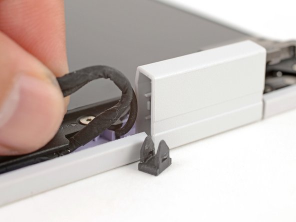

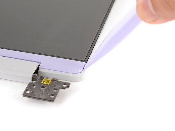

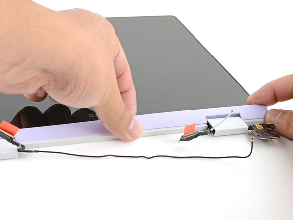

  29. The Display Cover is held in place with magnets along its top edge and clips along its remaining edges. Use the flat end of your Framework Screwdriver to pry up the right edge of the Display Cover.
    • The Display Cover is held in place with magnets along its top edge and clips along its remaining edges.
    • Use the flat end of your Framework Screwdriver to pry up the right edge of the Display Cover.
  30. Slide your fingers under the top edge of the Display Cover to release it from the laptop. Slide your fingers under the top edge of the Display Cover to release it from the laptop.
    • Slide your fingers under the top edge of the Display Cover to release it from the laptop.
  31. Remove the Display Cover.
    • Remove the Display Cover.

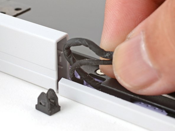

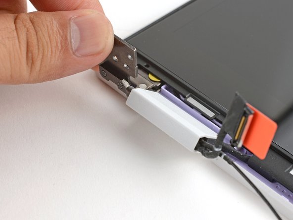

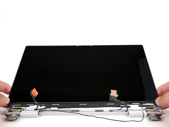

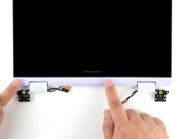

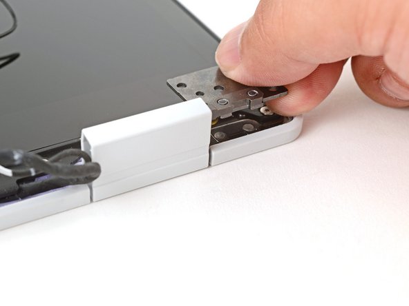

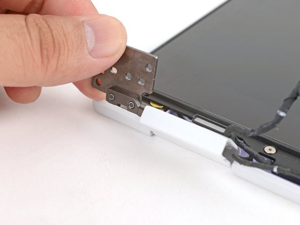

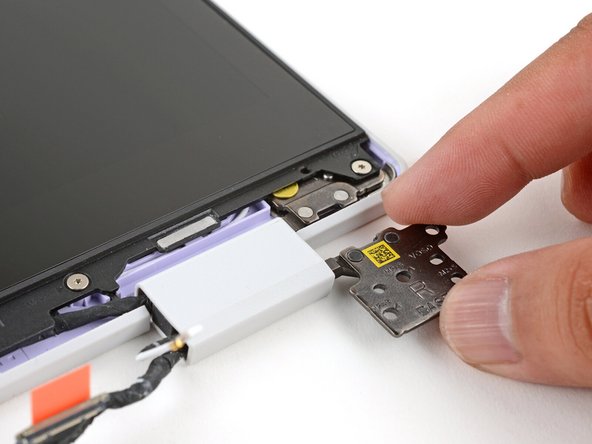

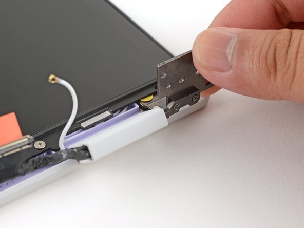

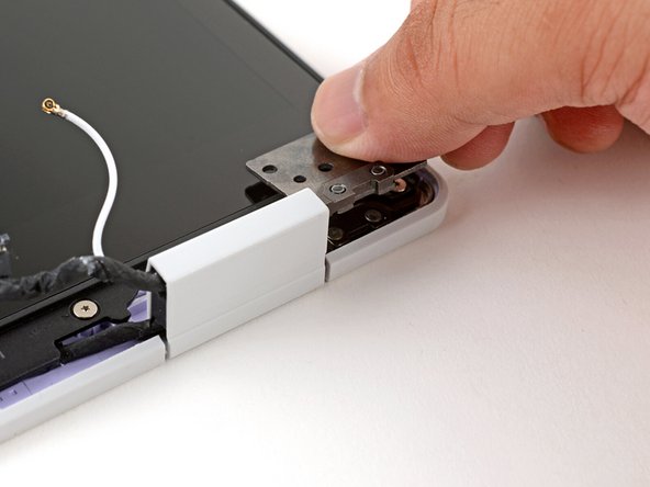

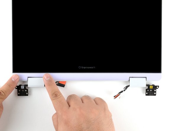

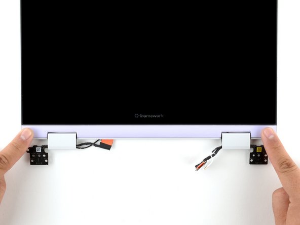

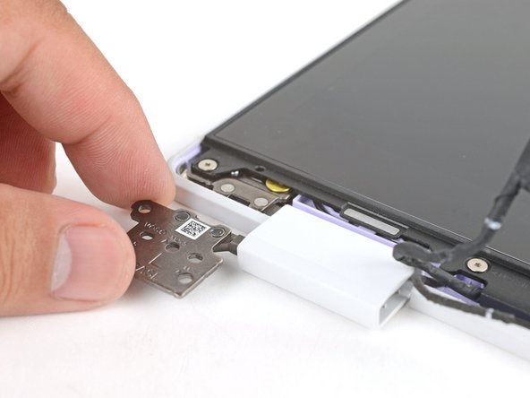

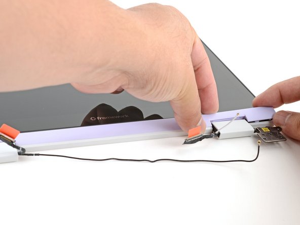

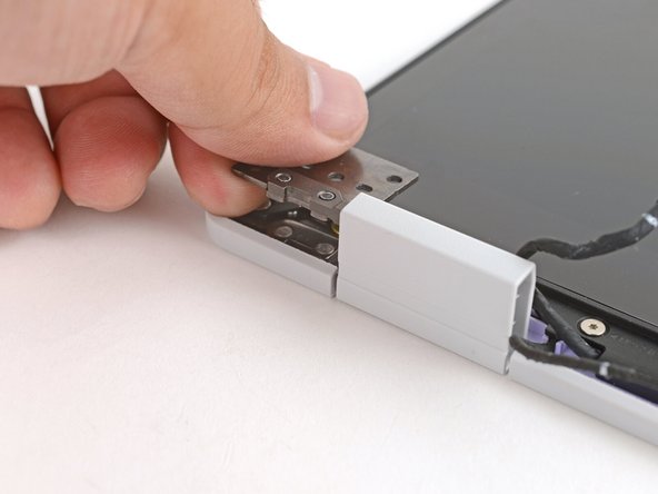

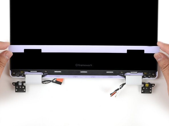

  32. Use your fingers to twist the right hinge plate until it's flipped on top of the display. The stiff hinge can be difficult to twist. Wear some work gloves, or use a cloth to help get a better grip. The stiff hinge can be difficult to twist. Wear some work gloves, or use a cloth to help get a better grip.
    • Use your fingers to twist the right hinge plate until it's flipped on top of the display.
    • The stiff hinge can be difficult to twist. Wear some work gloves, or use a cloth to help get a better grip.

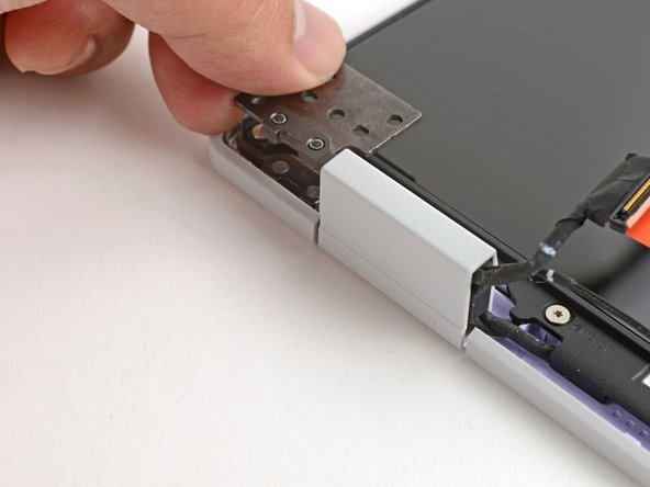

  33. Twist the left hinge plate until it's flipped on top of the display. Twist the left hinge plate until it's flipped on top of the display. Twist the left hinge plate until it's flipped on top of the display.
    • Twist the left hinge plate until it's flipped on top of the display.

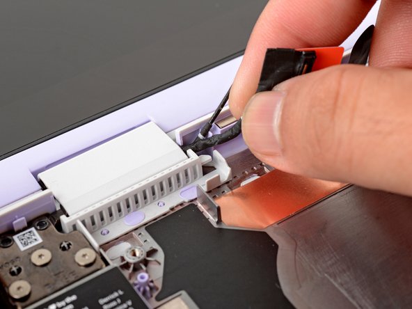

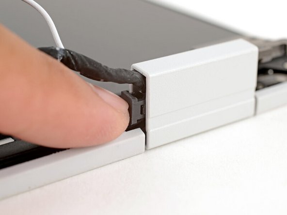

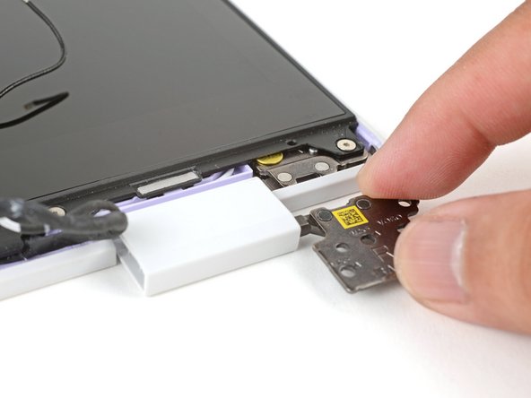

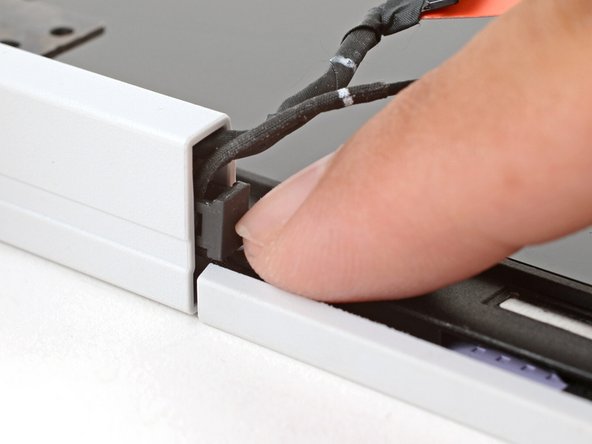

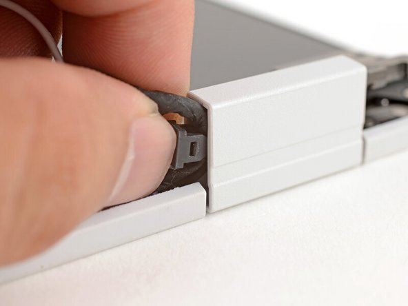

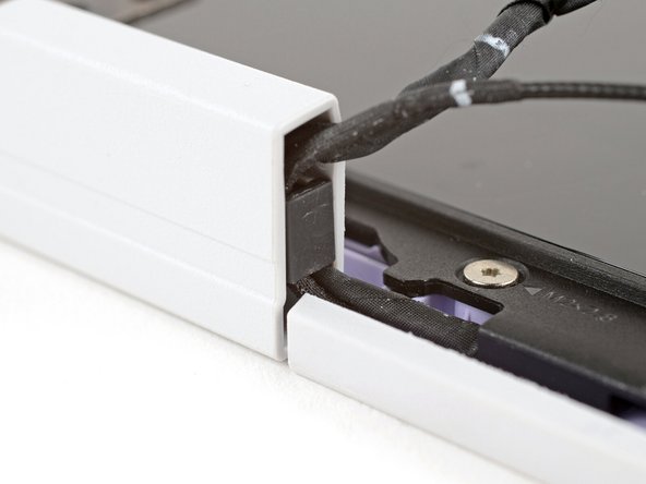

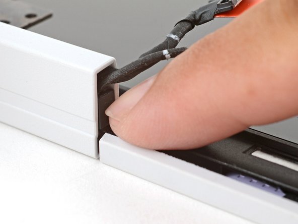

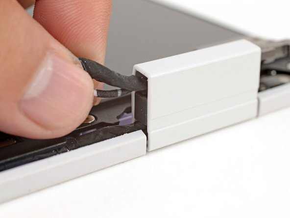

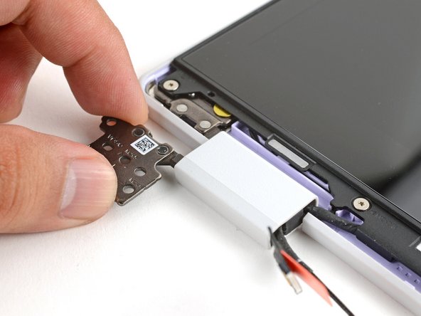

  34. Use your fingers to grab the two cables coming out of the left hinge. Pull gently to pop out the black cable clip and release the cables.
    • Use your fingers to grab the two cables coming out of the left hinge.
    • Pull gently to pop out the black cable clip and release the cables.

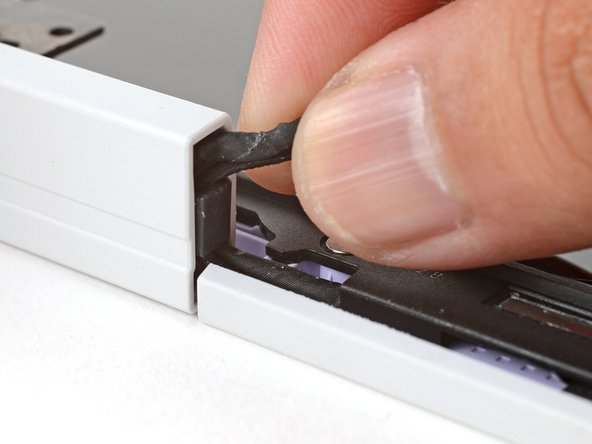

  35. Repeat the procedure on the right hinge to release the cables. Repeat the procedure on the right hinge to release the cables.
    • Repeat the procedure on the right hinge to release the cables.

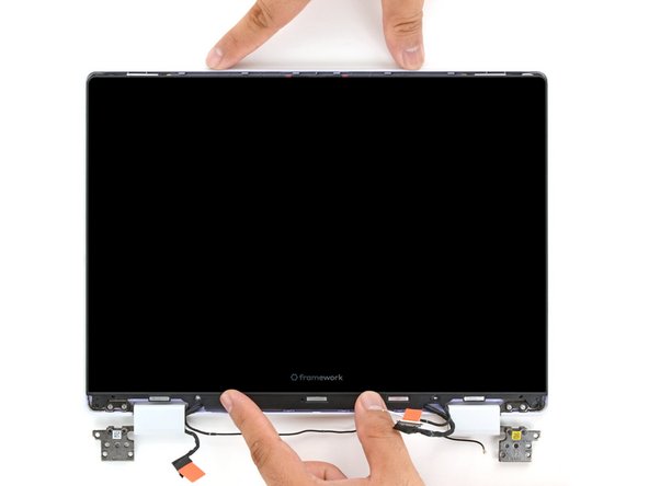

  36. Use your fingers to twist both hinge plates back down so they lay flat on your work surface. Use your fingers to twist both hinge plates back down so they lay flat on your work surface. Use your fingers to twist both hinge plates back down so they lay flat on your work surface.
    • Use your fingers to twist both hinge plates back down so they lay flat on your work surface.

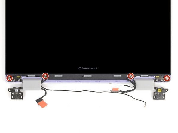

  37. Use your Framework Screwdriver to remove the four 3.3 mm‑long T5 Torx screws securing the display to the Top Cover.
    • Use your Framework Screwdriver to remove the four 3.3 mm‑long T5 Torx screws securing the display to the Top Cover.

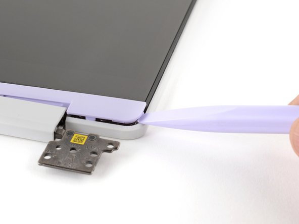

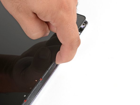

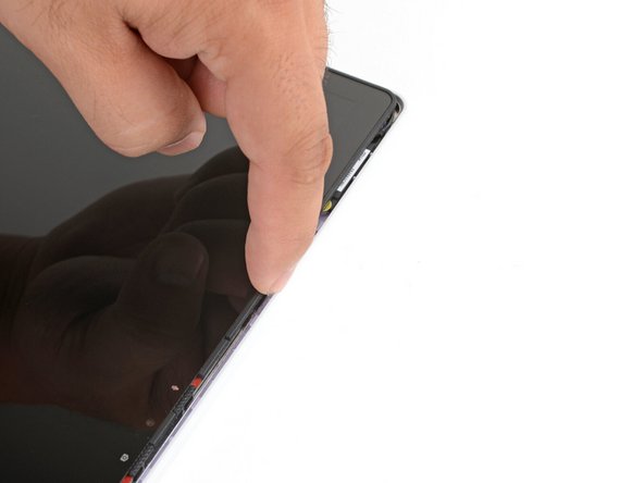

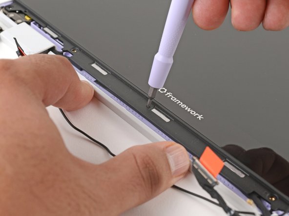

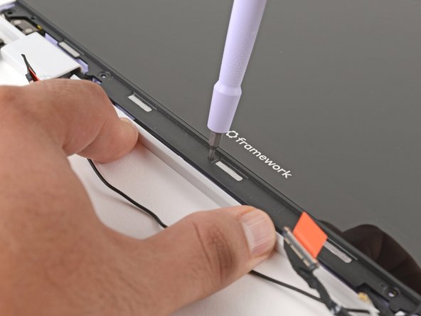

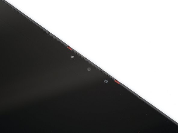

  38. Use your fingers to hold the bottom edge of the Top Cover in place. Insert the bit end of your Framework Screwdriver into the small hole on the display, below the Framework logo.
    • Use your fingers to hold the bottom edge of the Top Cover in place.
    • Insert the bit end of your Framework Screwdriver into the small hole on the display, below the Framework logo.
    • Slide the display down towards the hinge edge to release the tabs holding the top edge of the display in place.

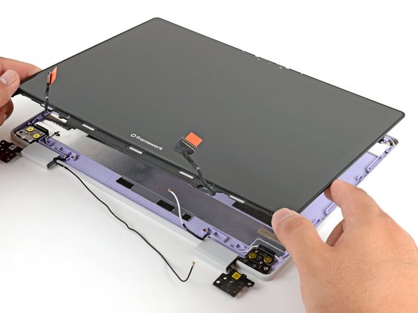

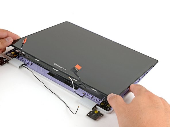

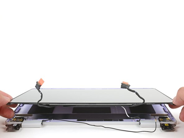

  39. Use your fingers to lift the top edge of the display from the Top Cover. Use your fingers to lift the top edge of the display from the Top Cover.
    • Use your fingers to lift the top edge of the display from the Top Cover.
  40. Lift and remove the display from the Top Cover. Lift and remove the display from the Top Cover.
    • Lift and remove the display from the Top Cover.

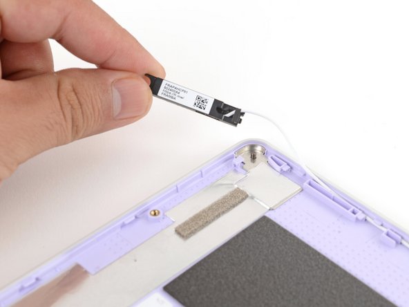

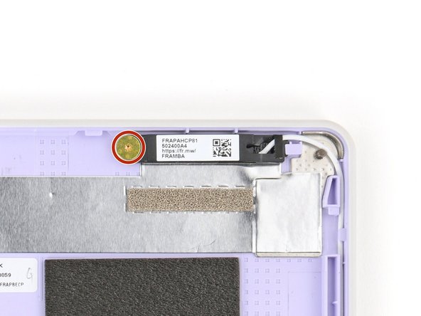

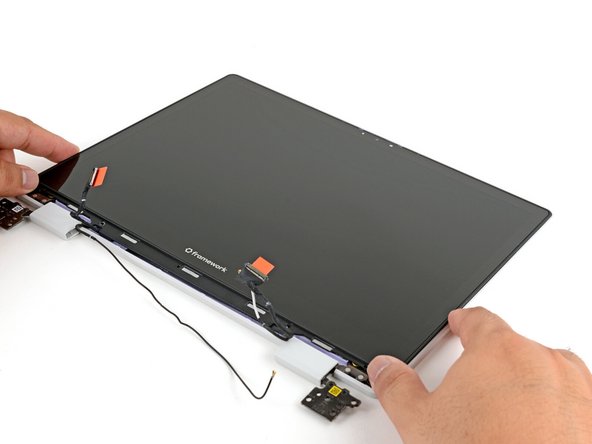

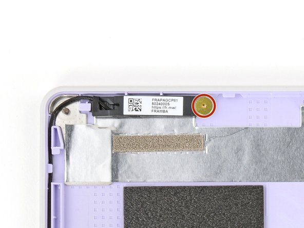

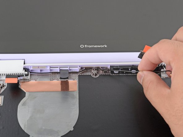

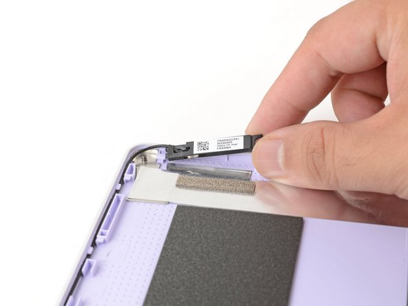

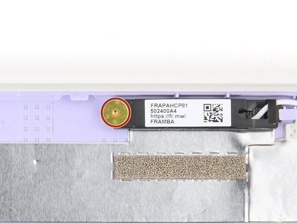

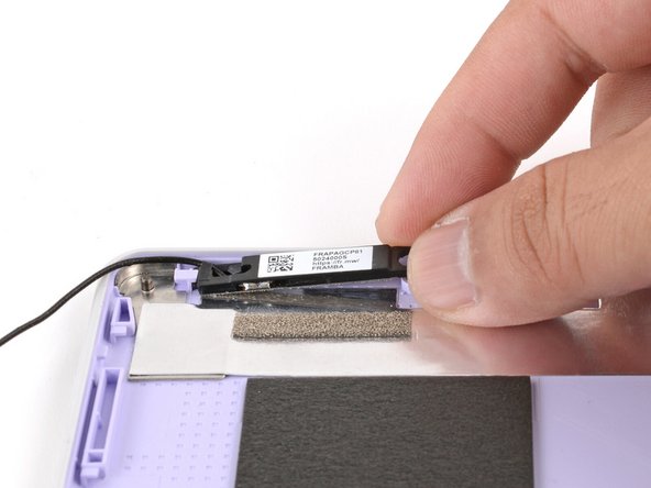

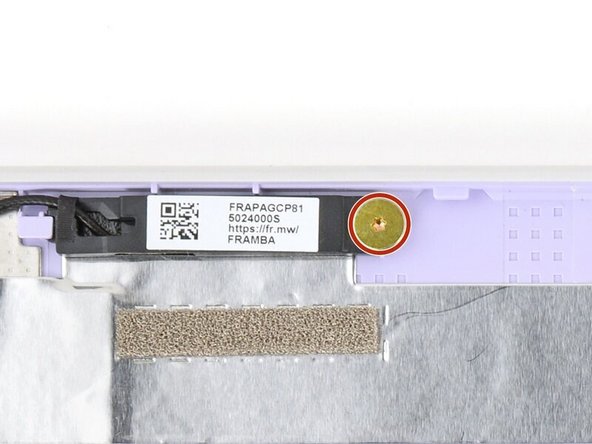

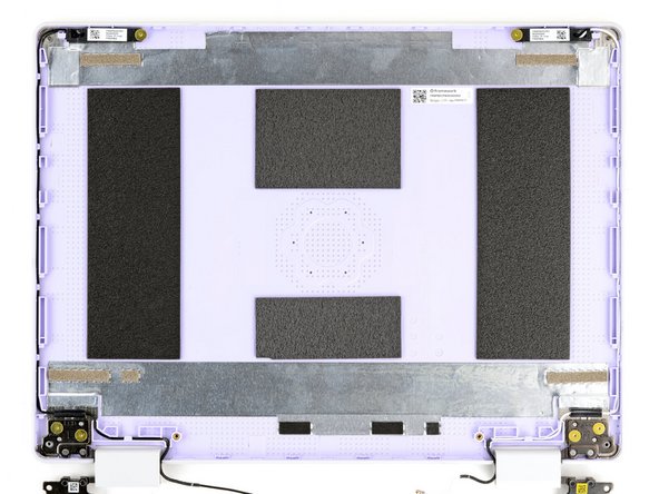

  41. Use your Framework Screwdriver to remove the two (one per antenna) 2.5 mm‑long T5 Torx screws securing the antennas to the Top Cover. Use your Framework Screwdriver to remove the two (one per antenna) 2.5 mm‑long T5 Torx screws securing the antennas to the Top Cover.
    • Use your Framework Screwdriver to remove the two (one per antenna) 2.5 mm‑long T5 Torx screws securing the antennas to the Top Cover.

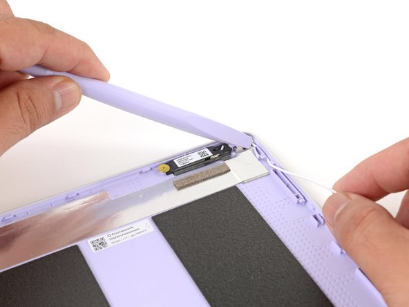

  42. Use your fingers to lift the right antenna away from the Top Cover. Carefully guide the white antenna cable out of its channel.
    • Use your fingers to lift the right antenna away from the Top Cover.
    • Carefully guide the white antenna cable out of its channel.
  43. Use your fingers to lift the left antenna away from the Top Cover. Carefully guide the black antenna cable out of its channel.
    • Use your fingers to lift the left antenna away from the Top Cover.
    • Carefully guide the black antenna cable out of its channel.
  44. Remove the antennas.
    • Remove the antennas.

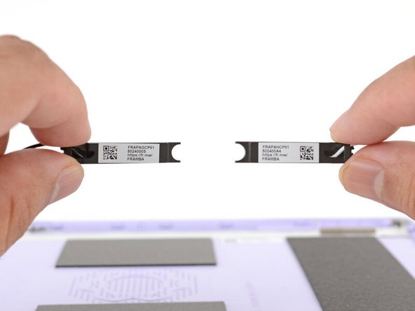

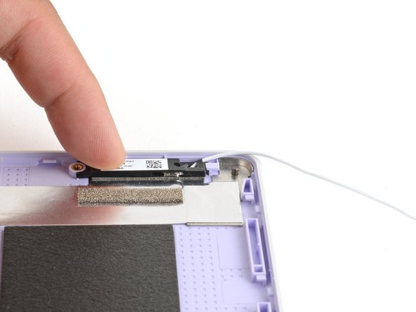

  46. To install the antennas, you'll fasten them onto the frame first, then route each antenna cable into its Top Cover channel. Lay each antenna in place in the Top Cover. Lay each antenna in place in the Top Cover.
    • To install the antennas, you'll fasten them onto the frame first, then route each antenna cable into its Top Cover channel.
    • Lay each antenna in place in the Top Cover.

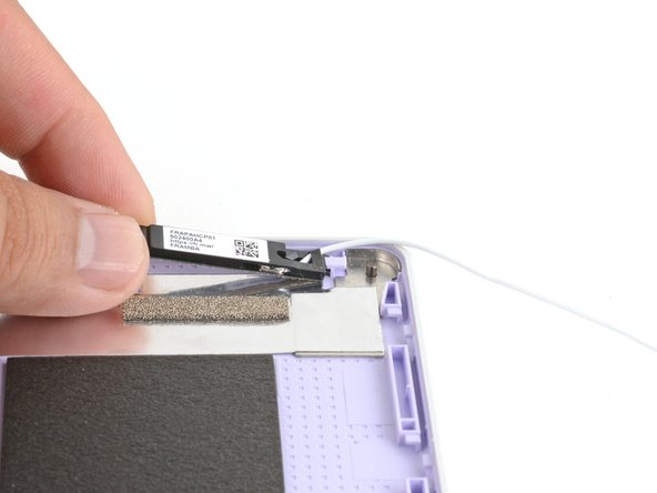

  47. Use your Framework Screwdriver to install the two (one per antenna) 2.5 mm‑long T5 Torx screws to secure the antennas to the Top Cover. Use your Framework Screwdriver to install the two (one per antenna) 2.5 mm‑long T5 Torx screws to secure the antennas to the Top Cover.
    • Use your Framework Screwdriver to install the two (one per antenna) 2.5 mm‑long T5 Torx screws to secure the antennas to the Top Cover.

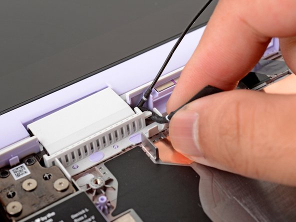

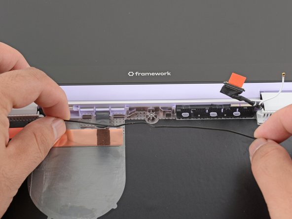

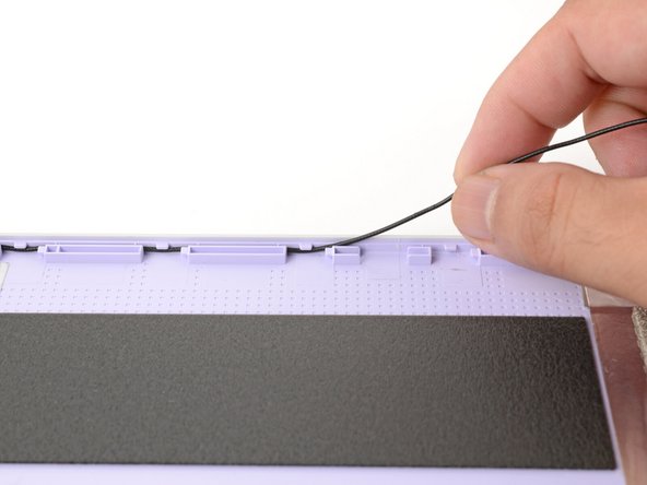

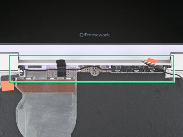

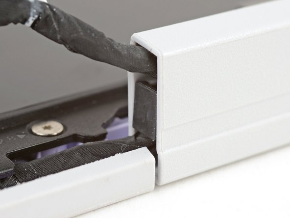

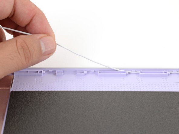

  48. Use your fingers and your Framework Screwdriver to carefully guide each antenna cable back into its channel. Zoom in on the second photo to see how the antenna cables sit in their channels.
    • Use your fingers and your Framework Screwdriver to carefully guide each antenna cable back into its channel.
    • Zoom in on the second photo to see how the antenna cables sit in their channels.

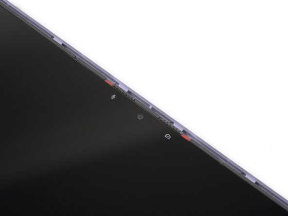

  49. Lay the display in place in the Top Cover, such that the top edge of the display is slightly below the top edge of the Top Cover. Lay the display in place in the Top Cover, such that the top edge of the display is slightly below the top edge of the Top Cover. Lay the display in place in the Top Cover, such that the top edge of the display is slightly below the top edge of the Top Cover.
    • Lay the display in place in the Top Cover, such that the top edge of the display is slightly below the top edge of the Top Cover.
  50. Use your fingers to slide the display upwards to latch the tabs on the top edge of the display. The top edge shouldn't have any gaps when the display's in place. The top edge shouldn't have any gaps when the display's in place.
    • Use your fingers to slide the display upwards to latch the tabs on the top edge of the display.
    • The top edge shouldn't have any gaps when the display's in place.

    • Tighten the screws until they're snug. Don't over-tighten them, or you may damage the screw tabs.
  52. Use your fingers to twist both hinge plates so they're flipped over the display. Use your fingers to twist both hinge plates so they're flipped over the display. Use your fingers to twist both hinge plates so they're flipped over the display.
    • Use your fingers to twist both hinge plates so they're flipped over the display.
  53. Place the cable clip around the right hinge cables, where they were bent from being inserted into the hinge. Use your fingers to press the clip into the hinge to secure the cables. Use your fingers to press the clip into the hinge to secure the cables.
    • Place the cable clip around the right hinge cables, where they were bent from being inserted into the hinge.
    • Use your fingers to press the clip into the hinge to secure the cables.
  54. Repeat the procedure on the left hinge to secure the left cables. Repeat the procedure on the left hinge to secure the left cables.
    • Repeat the procedure on the left hinge to secure the left cables.
  55. Make sure both cable clips are fully inserted into the hinges, so that they won't be snagged when the hinges pivot. Make sure both cable clips are fully inserted into the hinges, so that they won't be snagged when the hinges pivot.
    • Make sure both cable clips are fully inserted into the hinges, so that they won't be snagged when the hinges pivot.
  56. Use your fingers to twist both hinge plates so that they lay flat on your work surface. Use your fingers to twist both hinge plates so that they lay flat on your work surface. Use your fingers to twist both hinge plates so that they lay flat on your work surface.
    • Use your fingers to twist both hinge plates so that they lay flat on your work surface.
  57. Lay the Display Cover in place below the display. Use your finger to press along the length of the Display Cover to snap it onto the laptop. Use your finger to press along the length of the Display Cover to snap it onto the laptop.
    • Lay the Display Cover in place below the display.
    • Use your finger to press along the length of the Display Cover to snap it onto the laptop.
  58. Use your fingers to lift the Top Cover hinges over the Bottom Cover lip. Lay the hinges in place in the Bottom Cover. Use the plastic alignment pins to align each hinge in place.
    • Use your fingers to lift the Top Cover hinges over the Bottom Cover lip.
    • Lay the hinges in place in the Bottom Cover.
    • Use the plastic alignment pins to align each hinge in place.
  59. Use your Framework Screwdriver to install the six 4.5 mm‑long T5 Torx screws securing the two hinges. Use your Framework Screwdriver to install the six 4.5 mm‑long T5 Torx screws securing the two hinges.
    • Use your Framework Screwdriver to install the six 4.5 mm‑long T5 Torx screws securing the two hinges.
  60. Use your fingers to gently press the webcam cable into its plastic channel. Use your fingers to gently press the webcam cable into its plastic channel.
    • Use your fingers to gently press the webcam cable into its plastic channel.
  61. Use your fingers and your Framework Screwdriver to carefully press and guide the black antenna cable back into its channel. Zoom in on the second image to see how the antenna cable sits in its channel.
    • Use your fingers and your Framework Screwdriver to carefully press and guide the black antenna cable back into its channel.
    • Zoom in on the second image to see how the antenna cable sits in its channel.
  62. Press the black loop over the antenna cable and onto the Bottom Cover. If it doesn't stick, use a bit of thin double-sided tape to hold it down. Press the black loop over the antenna cable and onto the Bottom Cover. If it doesn't stick, use a bit of thin double-sided tape to hold it down.
    • Press the black loop over the antenna cable and onto the Bottom Cover. If it doesn't stick, use a bit of thin double-sided tape to hold it down.
  63. Carefully lay the Mainboard in the laptop. Use the two alignment pins to help align the Mainboard to the laptop.
    • Carefully lay the Mainboard in the laptop.
    • Use the two alignment pins to help align the Mainboard to the laptop.
    • Be careful not to trap the webcam, display, and antenna cables under the Mainboard as you set it in place.
  64. Use your Framework Screwdriver to tighten the five captive T5 Torx screws to secure the Mainboard.
    • Use your Framework Screwdriver to tighten the five captive T5 Torx screws to secure the Mainboard.
  65. Use your fingers to grab the orange tab on the display cable, located near the right hinge. Align and press the display cable straight down onto its connector.
    • Align and press the display cable straight down onto its connector.
  66. Use your fingers to grab the orange tab on the webcam cable, located near the left hinge. Align and press the webcam cable straight down onto its connector.
    • Align and press the webcam cable straight down onto its connector.
  67. Hold the Wi-Fi card by its edges. Don't touch the gold contacts with your fingers. If you do, wipe the contacts with a clean, lint-free cloth to remove any finger oils. Align the Wi-Fi card's gold contacts and notch with the socket on the Mainboard.
    • Hold the Wi-Fi card by its edges. Don't touch the gold contacts with your fingers. If you do, wipe the contacts with a clean, lint-free cloth to remove any finger oils.
    • Align the Wi-Fi card's gold contacts and notch with the socket on the Mainboard.
    • Insert the Wi-Fi card into the socket at a shallow angle. The gold contacts should mostly be covered by the socket.
    • The Wi-Fi card fits into the socket in one orientation. If it doesn't fit, try flipping the module.
  68. Hold the Wi-Fi card down with your finger. Position the black antenna cable connector over the left Wi-Fi card's coaxial socket. Tweezers can help position the connector.
    • Hold the Wi-Fi card down with your finger.
    • Position the black antenna cable connector over the left Wi-Fi card's coaxial socket.
    • Repeat the procedure with the white antenna cable.
  69. Slide the Wi-Fi bracket over the top edge of the Wi-Fi card. Slide the Wi-Fi bracket over the top edge of the Wi-Fi card.
    • Slide the Wi-Fi bracket over the top edge of the Wi-Fi card.
  70. Use your Framework Screwdriver to tighten the captive T5 Torx screw to secure the Wi-Fi card.
    • Use your Framework Screwdriver to tighten the captive T5 Torx screw to secure the Wi-Fi card.
  71. Use your fingers to lay the Power Button Board in place. Use the two plastic pins on the laptop to align the Power Button Board. Use the two plastic pins on the laptop to align the Power Button Board.
    • Use your fingers to lay the Power Button Board in place.
    • Use the two plastic pins on the laptop to align the Power Button Board.
  72. Use your Framework Screwdriver to tighten the captive T5 Torx screw to secure the Power Button Board.
    • Use your Framework Screwdriver to tighten the captive T5 Torx screw to secure the Power Button Board.
    • Tighten the screw until it's snug. Don't over-tighten it, or you may strip the screw.
  73. Insert the Audio Board into the laptop at an angle to help align the headphone jack. Use the two plastic alignment pins on the laptop to help with final alignment. Use the two plastic alignment pins on the laptop to help with final alignment.
    • Insert the Audio Board into the laptop at an angle to help align the headphone jack.
    • Use the two plastic alignment pins on the laptop to help with final alignment.
  74. Use your Framework Screwdriver to tighten the captive T5 Torx screw to secure the Audio Board.
    • Use your Framework Screwdriver to tighten the captive T5 Torx screw to secure the Audio Board.
