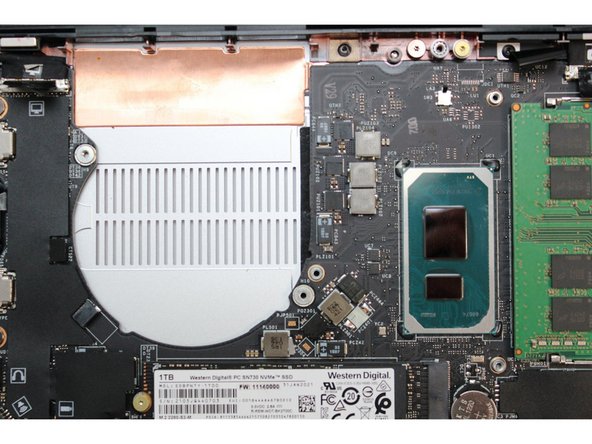

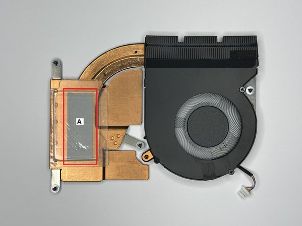

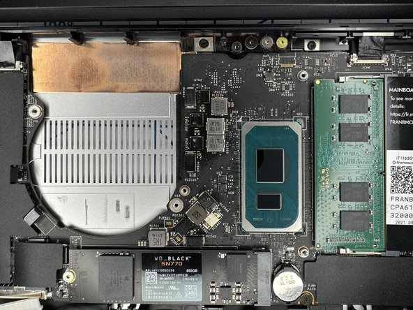

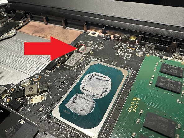

  5. Before installing a brand new Heatsink and Fan module, be sure to carefully wipe off the excess thermal paste from the CPU using a clean, lint-free tissue, cloth, or cotton swab.  The new module has new thermal paste on it. Look for any thermal pads that might have remained stuck on the Mainboard.   They are light in color and very soft to the touch.  If you notice any, gently peel them off. Also make sure all of the thermal pads are properly in place in the new Heatsink.  If a thermal pad is missing, there is risk of power regulators overheating.
    • Before installing a brand new Heatsink and Fan module, be sure to carefully wipe off the excess thermal paste from the CPU using a clean, lint-free tissue, cloth, or cotton swab. The new module has new thermal paste on it.
    • Look for any thermal pads that might have remained stuck on the Mainboard. They are light in color and very soft to the touch. If you notice any, gently peel them off.
    • Also make sure all of the thermal pads are properly in place in the new Heatsink. If a thermal pad is missing, there is risk of power regulators overheating.

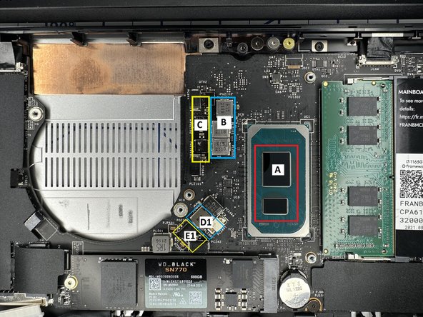

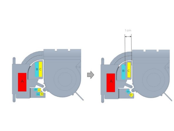

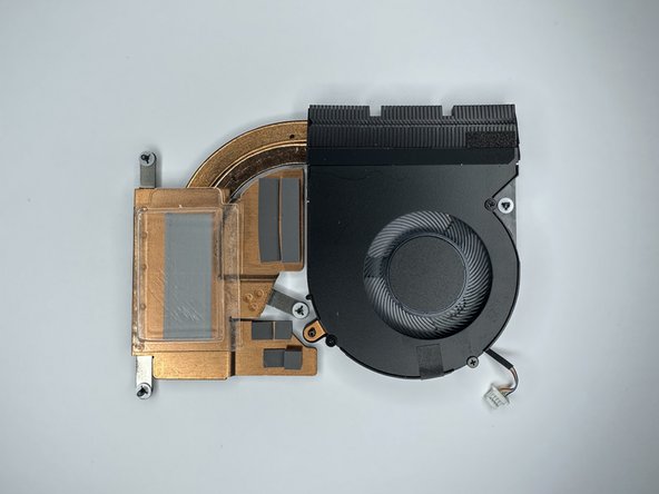

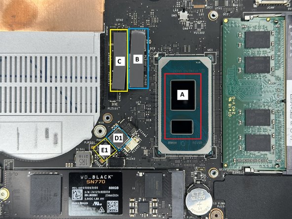

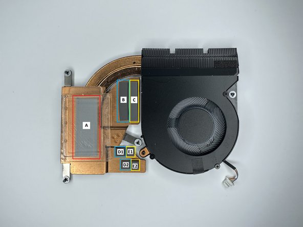

  6. Since you will be using a 12th & 13th Gen designed HSF Kit,  you will be moving Thermal Pads from the new HSF to the correct location on the Mainboard. First image shows approximate location of where new Thermal Pads will contact the Heatsink Kit. Second image shows picture of Heatsink Kit as you would receive it and labeled to match first image.
    • Since you will be using a 12th & 13th Gen designed HSF Kit, you will be moving Thermal Pads from the new HSF to the correct location on the Mainboard.
    • First image shows approximate location of where new Thermal Pads will contact the Heatsink Kit.
    • Second image shows picture of Heatsink Kit as you would receive it and labeled to match first image.
    • There will be some Thermal Pads which are not needed. Pay careful attention to make sure you use them in the correct places.
    • You will not be using Thermal Pads labeled D2 and E2.
    • Do NOT remove or touch the Thermal Paste for the CPU which is Label A.

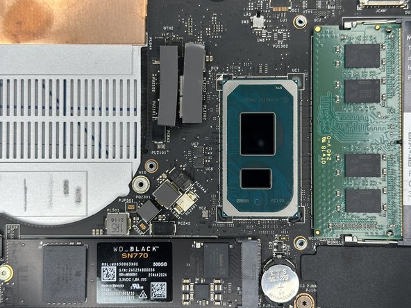

  7. Following the Thermal Pad assignments from the previous step, gently move the Thermal Pads from the Heatsink to the Mainboard using the Spudger from your Framework Screwdriver to peel them up. Be careful not to damage the Thermal Pads as you peel them up. This includes moving over Thermal Pads; B, C, D1, and E1. Thermal Pads labeled D2 and E2 from the previous step will not be used. We recommend setting these pads to the side for now.
    • Following the Thermal Pad assignments from the previous step, gently move the Thermal Pads from the Heatsink to the Mainboard using the Spudger from your Framework Screwdriver to peel them up. Be careful not to damage the Thermal Pads as you peel them up.
    • This includes moving over Thermal Pads; B, C, D1, and E1.
    • Thermal Pads labeled D2 and E2 from the previous step will not be used. We recommend setting these pads to the side for now.

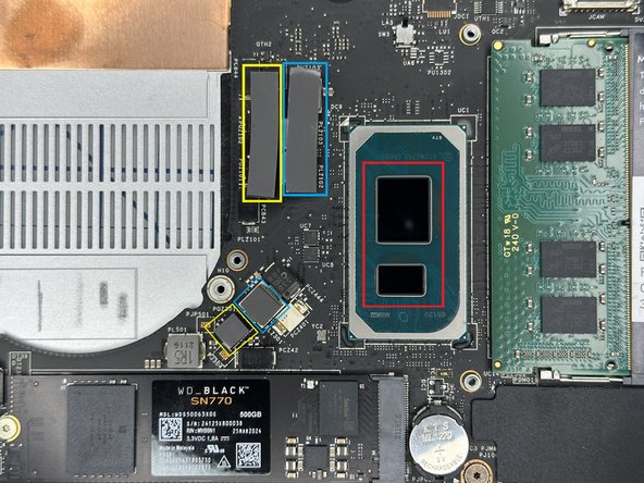

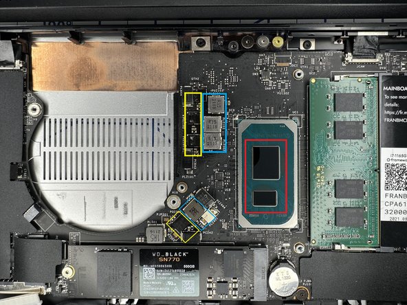

  8. When the Thermal Pads are successfully transferred from the Heatsink Kit to the Mainboard, it will look like this. Only the Thermal Paste for the CPU (Labeled A) will be the remaining thermal item on the Heatsink Kit. Only the Thermal Paste for the CPU (Labeled A) will be the remaining thermal item on the Heatsink Kit.
    • When the Thermal Pads are successfully transferred from the Heatsink Kit to the Mainboard, it will look like this.
    • Only the Thermal Paste for the CPU (Labeled A) will be the remaining thermal item on the Heatsink Kit.

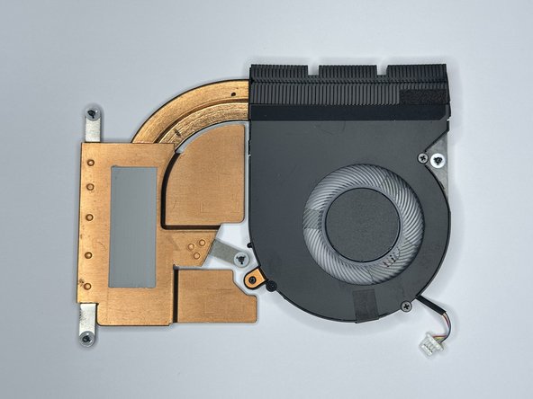

  9. Once Thermal Pads are in the correct spot, remove the plastic cover protecting the Thermal Paste on the Heatsink Kit (Labeled A). Once Thermal Pads are in the correct spot, remove the plastic cover protecting the Thermal Paste on the Heatsink Kit (Labeled A).
    • Once Thermal Pads are in the correct spot, remove the plastic cover protecting the Thermal Paste on the Heatsink Kit (Labeled A).
